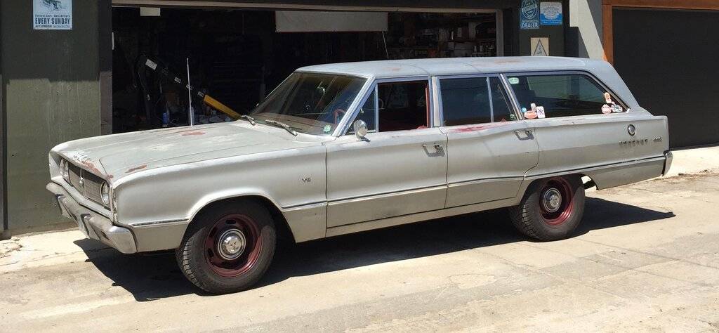

    This is my wagon, it is closer in size to your car then the full size C-bodies.
    The wagon has 255/60r15 front and 275/60r15 rear, Cooper cobra tires.
    • Like Like x 2

    Wheel size is 15x7 4" BS front, 15x8 4.5" BS rear. Just how factory would do it.

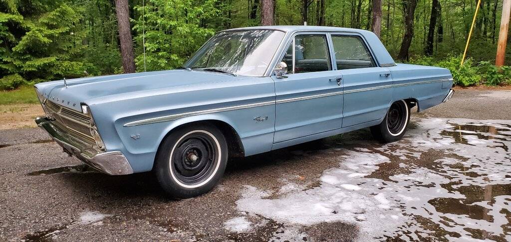

    I found a picture of when I first bought the car with 15 inch wheels and 235/75 tires. I took the 15s off because the tires were so dry rotted they started to leak. So I took the oe 14s and out them on but the tire size is not what it came with from factory.
    • Like Like x 2

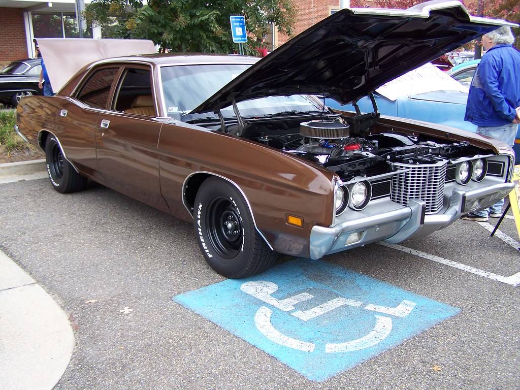

    • Like Like x 4
    • Thanks! Thanks! x 1
