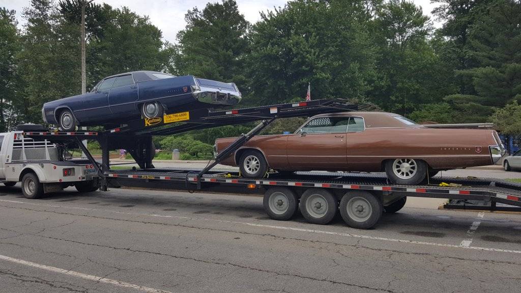

I have a 72 2 door, sunroof car. I am having it restored, so we are talking about the whether to replace the vinyl top, or to paint the top. Any opnions out there? We are looking at a brown metallic color with a lot of pearl in it. PPG Sunset Bronze Metallic. Looks great in the sun. The car is solid, some issues with the sunroof, but all else is good. Ignore the wheels, we will go back to original wheel covers. BTW, the blue one I am thinking of selling. It is a 73. (I remove the skirts to put the wheel straps on the rear)

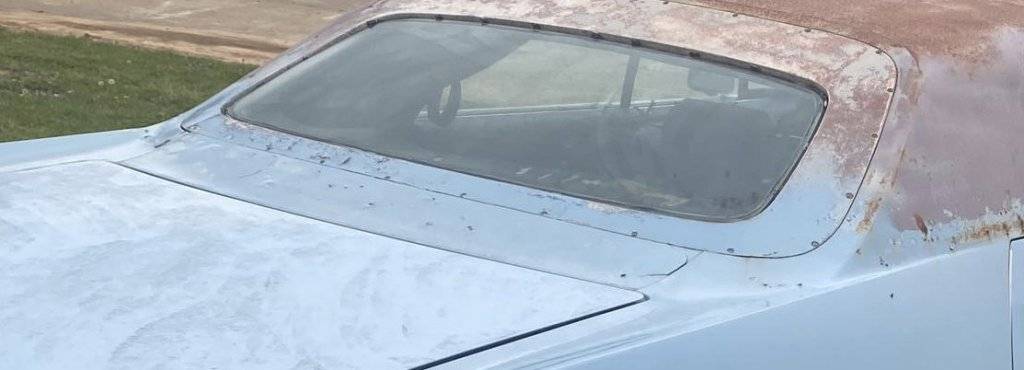

I would agree on keeping a rare sunroof car original. But since those Imperials came with a vinyl top because of the rear window plug, how would you plan to cover that when painting the roof? It looks quite ugly and I'm not sure whether paint will stick to that material
If staying with the original look, the Imperial roof grain on the vynal material is called levant, which has a different pattern from the boars grain that came on the Chryslers.
I'm with everyone else, keep the vynal top.
Could that plug not be "body worked" into the existing sheet metal, as the factory might have done IF they had wanted to spend the money to do it? Although it is easier to cover it with vinyl and some filler than to do the additional work. Which is why all Superbirds had vinyl roofs.

I highly doubt that´s possible in a way it looks all perfect afterwards. Only thing I could imagine if you´re a really talented body man, you could replace the plug by welding. BUT you would have to fabricate a frame for the rear window an make sure the trim fits afterwards... I doubt that filler or fiberglass would work with the paint on it without cracking after a while
