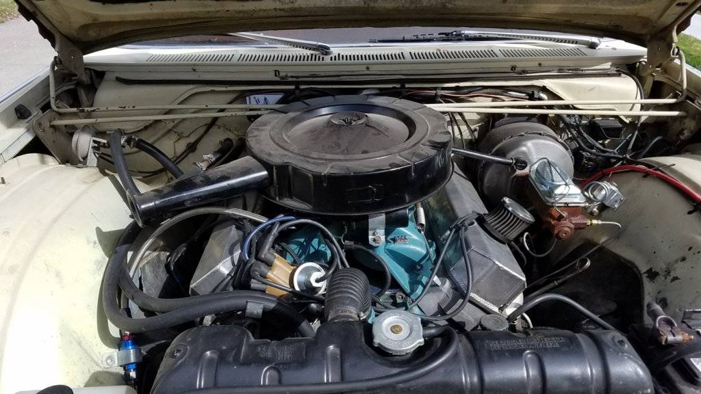

After my comp cams hydraulic lifter failure on the way to a car show last summer, I replaced my cam and lifters with a straub technologies custom grind cam and morrel lifters. (comp blew me off, so no more comp cams for me)
went back to the track today and ran
[email protected]
60' 1.71
I still think it will go 11.99
505 stroker, cnc'd stealths, full TTI exhaust, 830 quick fuel, perfromer RPM
2800 Stall
4767lbs race weight
3:23 gear with detroit locker
275/60/15 M&H racemaster drag radials ©22 psi
