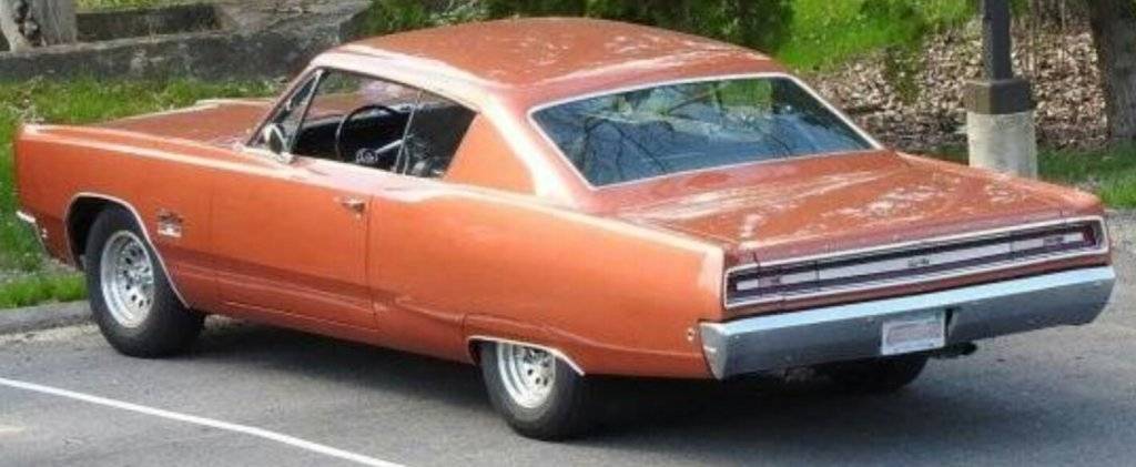

80 degrees today. Could not resist.

Thanks for all replies! I really enjoy driving my Fury, especially with that new Hemi.
I was a little worried about coolant temps on my way home, but I think it`s ok. With 3.55 rear gears it spins at 3200 RPM on the highway (75MPH) and the coolant temp stayed between 208-210 °F (manual calls for 205 as normal operating temp).
I get off the highway, coming off the ramp I hit the pedal, the engine revs up to 4000 RPM and I see the coolant temp immediately goes to 218°F. Electric fan kicked in and within 30 sec coolant temp was down to 212 (and I thought my old 440 was running hot at 200..)
Later I checked stock Hemi PCM and it is configured to turn the fans on at 226°F (my fan is not controlled by PCM), so I think it is fine.
