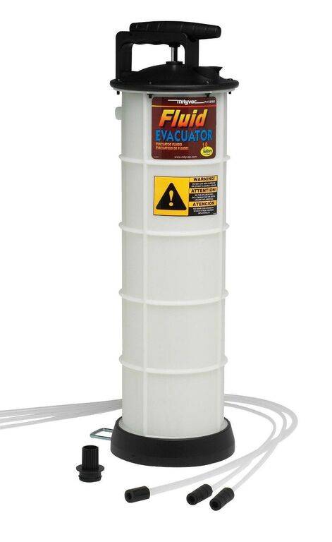

These Mityvacs work well:
Mity-Vac MV7400 Fluid Evacuator with 1.9 gal Capacity Reservoir | eBay
Harbor Freight sells their own version in the stores if you are in a hurry and have one close by.

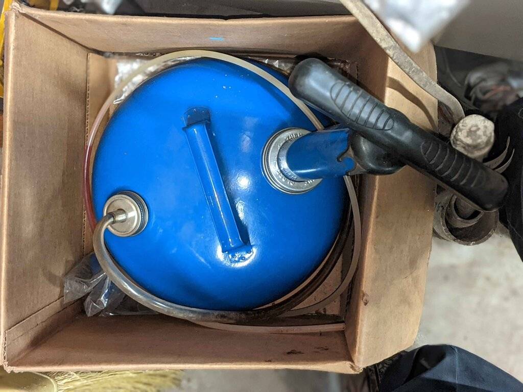

We use these pumps to drain components but we drain many gallons at a time not 5 or 6 quarts. It’s not the best way to change your passenger car oil...

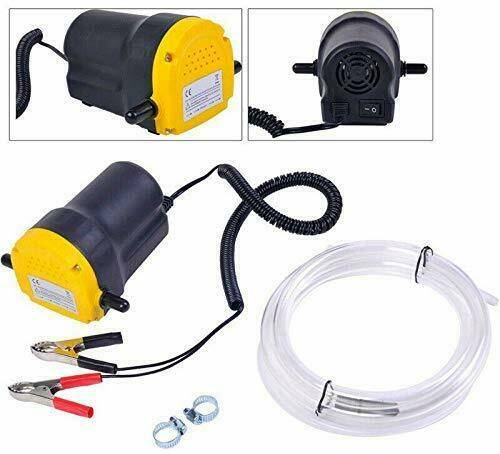

There are also electric "extractors" for use with lawn machinery (as in riding lawn mowers) which are smaller and about $30.00 or so. Not being able to get the oil drain activated on the zero turn mower I co-opted, I found one on Amazon and ordered it, only to later see something very similar at Home Depot. It works quickly and well. Has some battery cable leads to hook it to the battery.
Just insert the smaller "clear" tube into the dipstick hole, IF it will go in far enough to get to oil. Hook up the leads and make sure to have the exit tube in a suitable recepticle. Over pretty quickly.

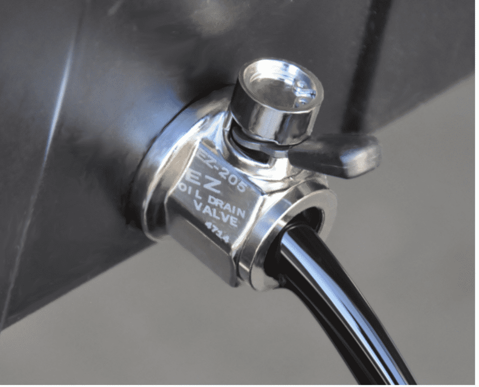

Geeez this is still ongoing? FFS how much does 5 quarts cost? Then install one of these for the next time you fluck up.

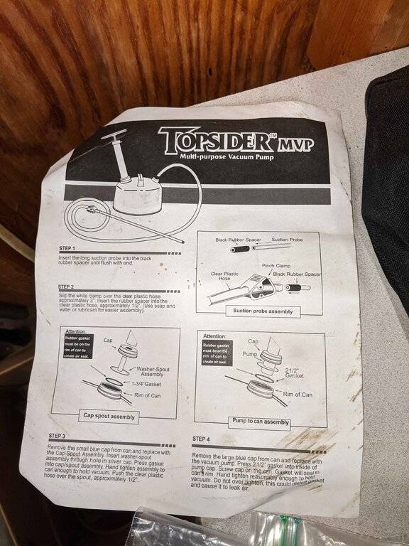

We had a 3.2 V6 2000 Concorde. The aluminum oil pan plug threads stripped out. I used a rubber plug. To change oil, I used this cheap Topsider oil vacuum pump from Harbor Freight. Eventually, after a 190k miles, the car had so many problems that I gave it a one way ticket to the scrap metal yard.
