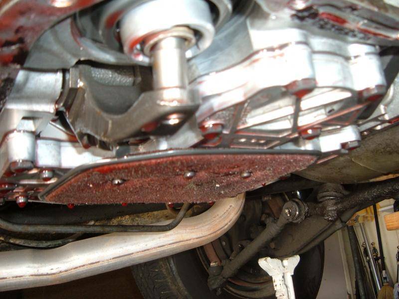

it looks to be very tilted to the side... being it is hydraulic it will be difficult to compress filled with tranny fluid..

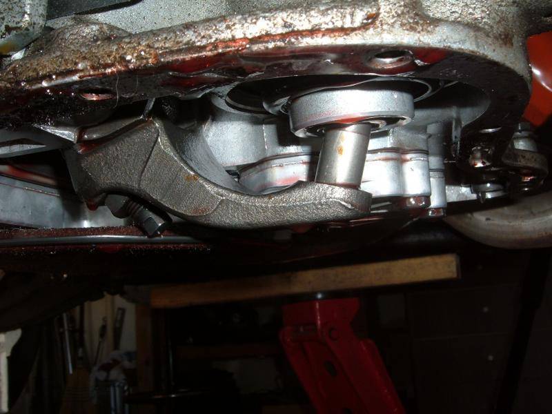

My last post is pics I took. I'm guessing the strut fell out or the band broke or a servo problem? It looks like the servo over extended itself from there being too much play if the strut fell out? The piston at the angle worries me as would it do this under these circumstances?
Next I'll drop the valve body...
there is a snap ring that holds the piston in the servo bore. Has it broken? Did you see any large pieces of metal in the pan?
Once you get the valve body out, you might be able to loosen the adjuster and pop the anchor and strut out and swing the lever away, then work on that snap ring.
