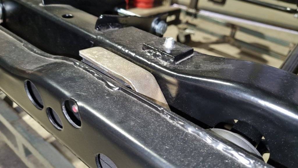

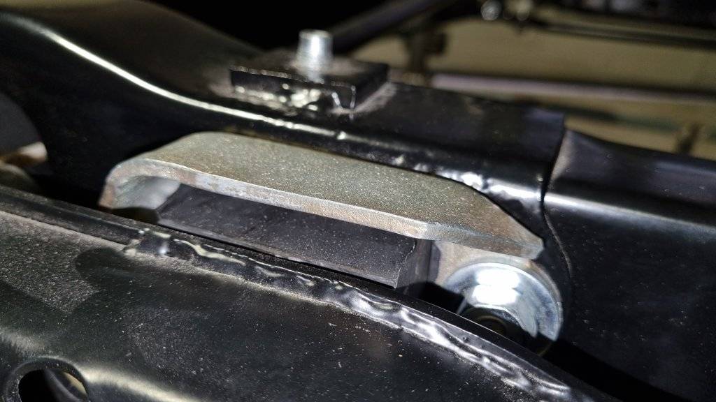

Good Afternoon All

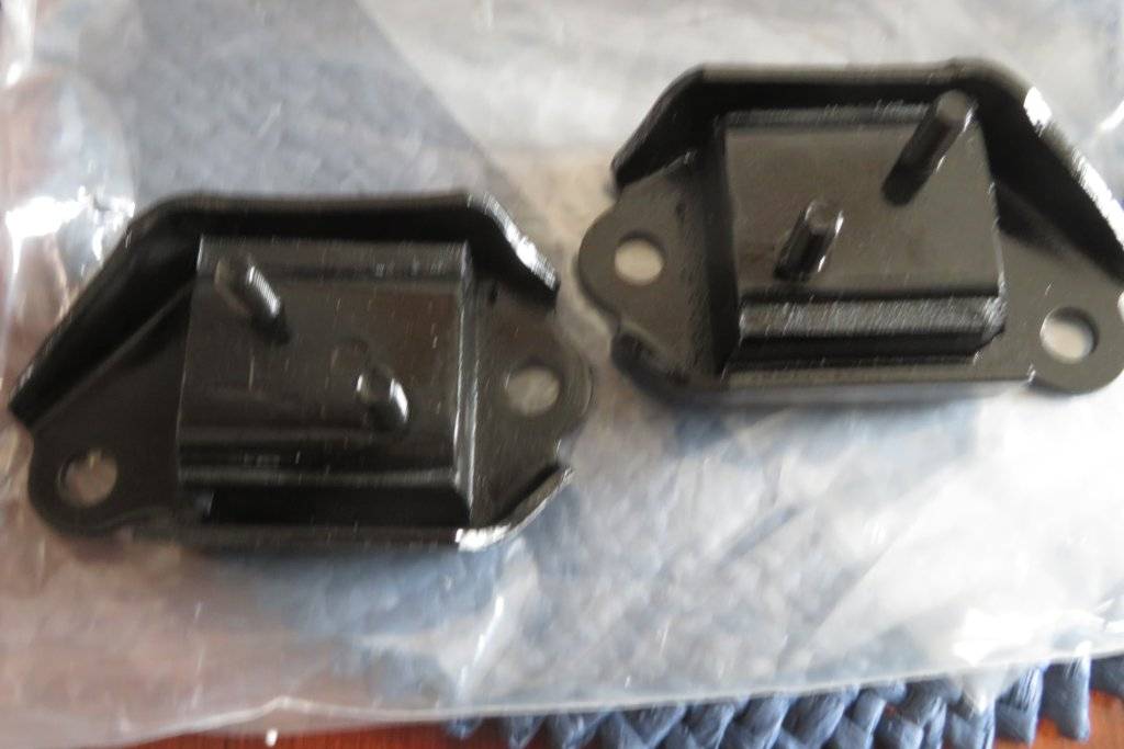

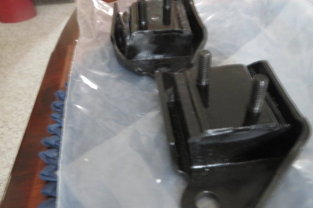

Just received the rebuilt torsion Bar isolators from 'Then and Now'.
Mailed on Tuesday from Massachusetts arrived on Thursday. They look great.
Here are a couple of pics along with there contact info:

So they take your original metal parts and re-vulcanize rubber onto them? Looks great. I should have saved my broken OEM motor mounts and had them re-cast since replacements are all made overseas.....

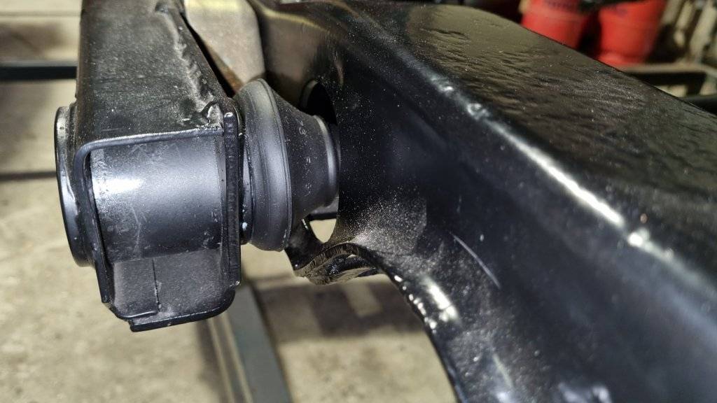

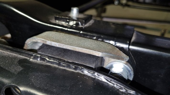

They do not work with thicker Torsion bars unfortunately. Or it's becasue the new torsion bars are not clocked. I'm not sure. But they don't work for me. :(
I had mine redone by them and unfortunately they are too soft in combination with my new Torsion Bars from FFI.
Left side: The rubber bottoms out on the metal part.

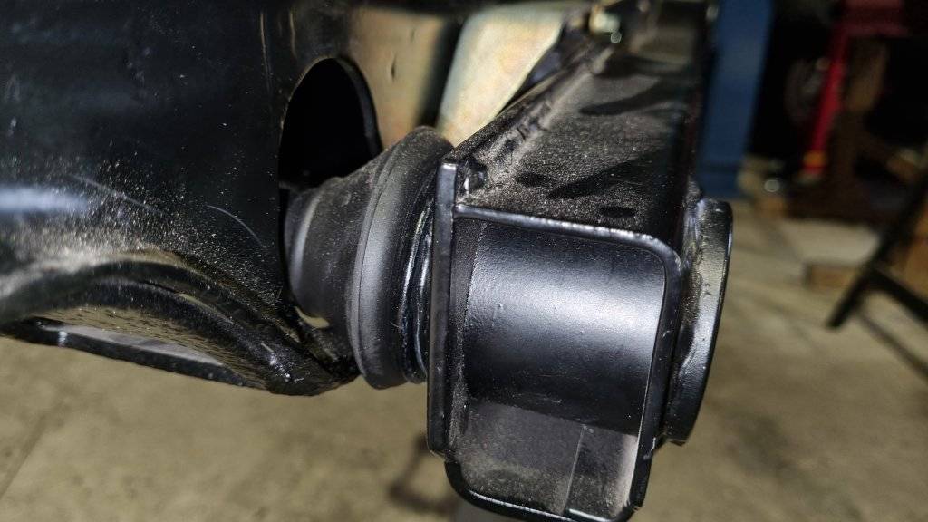

Right side: Is as it should be.
