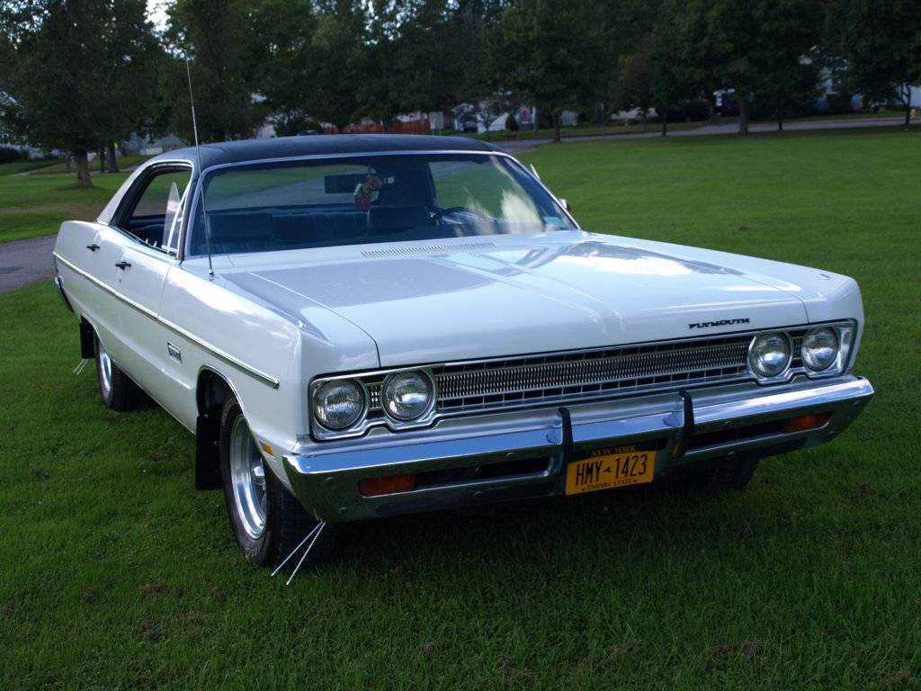

    Howdy folks...been away for a while..just pulled the cover off Moby Dick and took her for a spin..it's been a long cold winter..looks like the snow is gone..she runs like a top..SUSPENSION ISSUE..I've had quite a few big Mopars..they all handled just fine..this car WALLOWS in the turns..every thing is good in the front end.. new tires, steering box, shocks, ball joints, etc...this car has no sway bar and I've looked high and low for a kit..I don't think they exist and doubt it has mounts anyway..QUESTION?..would new torsion bars help the problem?..the car is a 318..do big blocks have bigger bars?..if so, are they a direct bolt in?..thoughts please..
