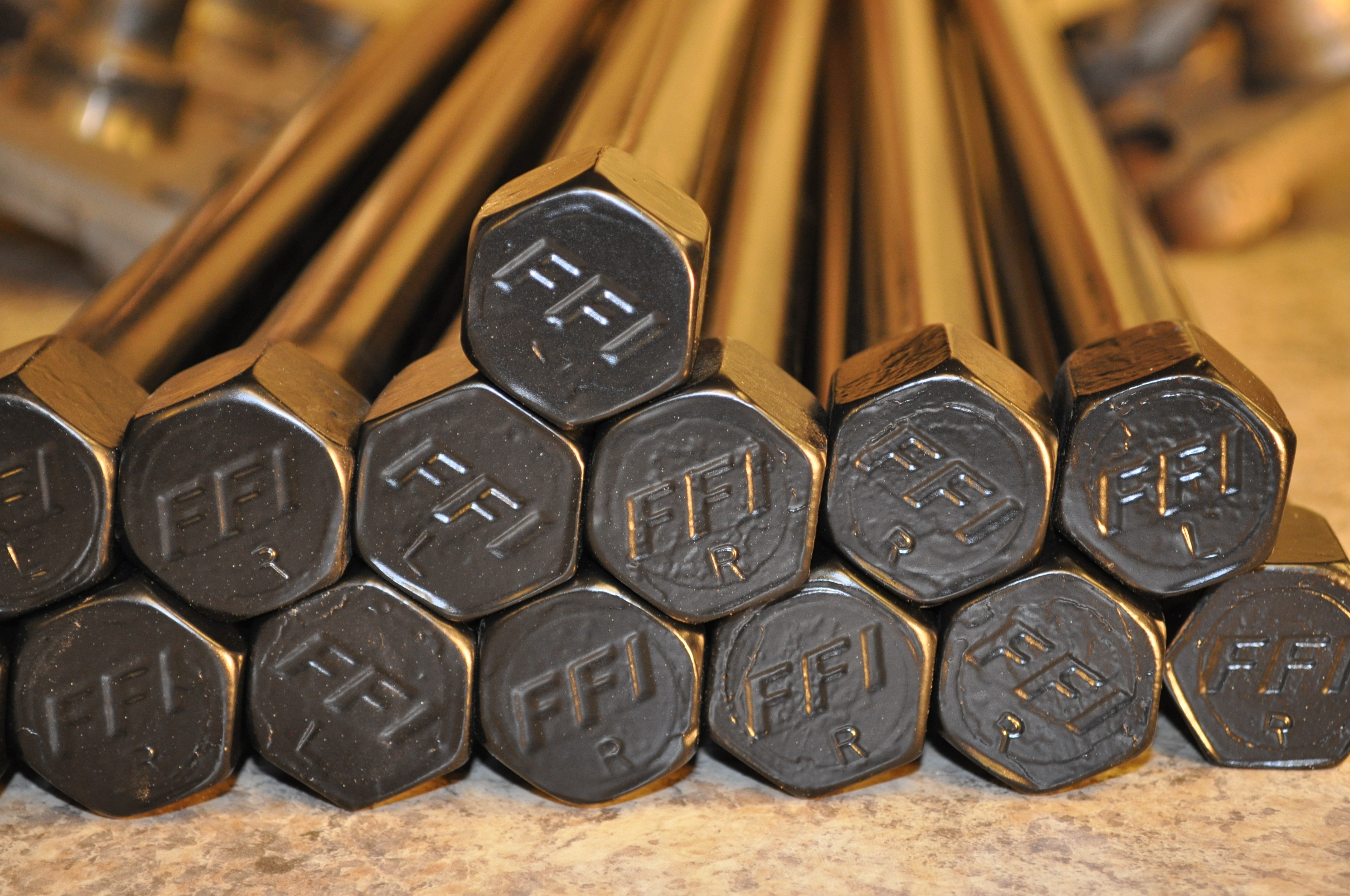

For example and only example...............
Firmfeel Mopar Suspension and Steering
FFI Torsion Bars
All Torsion Bars are made in house, heat treated and powder coated black.
For customers that want OE torsion bars with correct forge number we offer complete reconditioning.
Click to see an FFI OE T.Bar
44" bars: Plymouth 1965-73, Dodge 1972-73
47" bars: Plymouth 1974-78, Dodge 1965-71, 1974-78, Chrysler 1965-1978, Imperial 1974-75
50" bars: Imperial 1967-1973
Custom Lengths Available
*Recommended*
Torsion Bar Dust Boots
TBDB2......$40
1.00 DIA. Stock App. (WR 142)
TBC4410....$385 (44")
TBC4710....$400 (47")
1.06 DIA. HD/Police App. (WR 185)
TBC4420....$385 (44")
TBC4720....$400 (47")
1.12 DIA. HD/Street App. (WR 220)
TBC4430....$400 (44")
TBC4730....$420 (47")
1.18 DIA. HD/Race App. (WR 280)
TBC4440....$420 (44")
TBC4740....$435 (47")
(Wheel Rate abbreviated WR)
*CUSTOM TORSION BARS - CALL*
