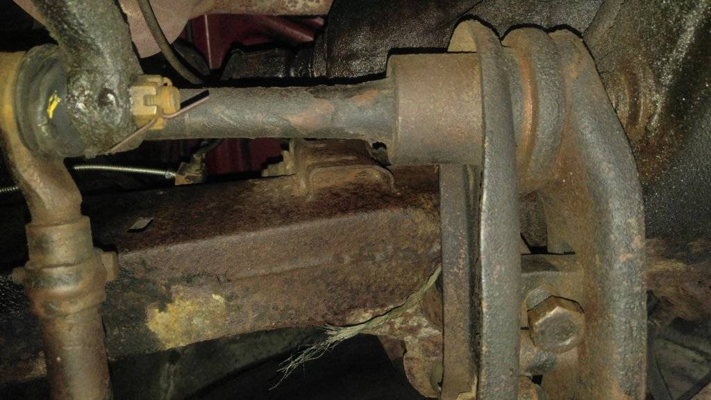

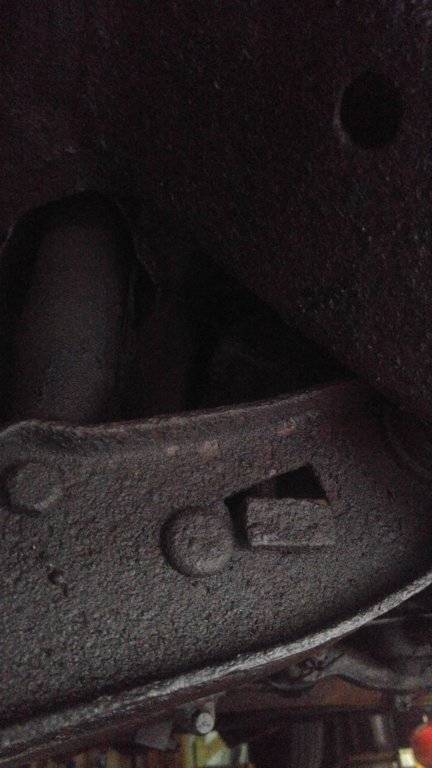

Okay here are the images as promised (and a day late).
