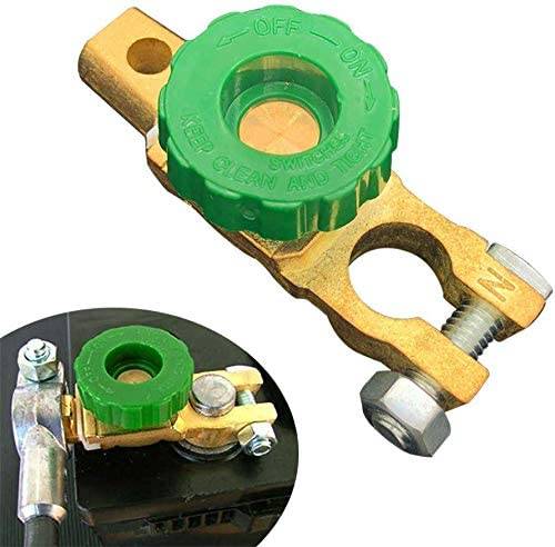

    Word to the wise - with any old car, it's advisable to carry a fire extinguisher with you in case things go bad. Our C bodies have a known fire risk in the bulkhead/ammeter design. If things down there are still original and the MAD conversion and other safety improvements haven't been done, it's a fire waiting to happen. That and a quick disconnect terminal on the negative side of the battery to cut power quickly as well. These two things can save your bacon from getting cooked. I always carry a fire extinguisher and my batteries are equipped with the quick disonnect.
    https://www.amazon.com/Ampper-Inter...SK01DDTEFCS&psc=1&refRID=CV7A3MMZ6SK01DDTEFCS
    https://www.amazon.com/Kidde-466112...71&sprefix=automotive+fire+ex,aps,200&sr=8-23

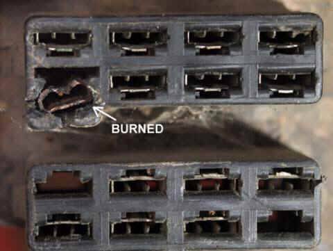

    I had a similar intermittent on my 69 Sport Fury vert many many years ago and it ended up being a corroded and burnt connection at my bulkhead connector. I hope this helps .....
