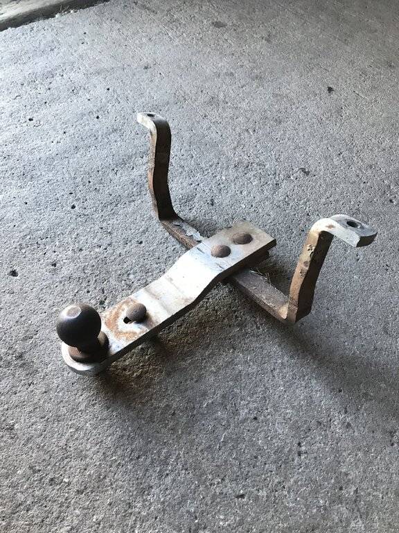

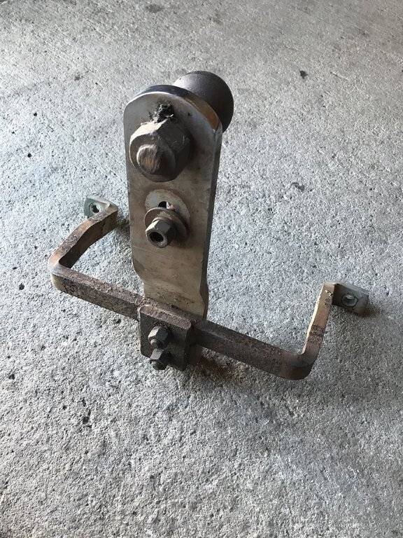

I happen to have a Hitch that I bought from a fellow member I WAS gonna use on my 75 NYB. But!..
I’ll pull it out take pics for ya and post. I’ll also get rail to rail measurements for you to see if it’ll fit within your rail. Maybe you can make it work.

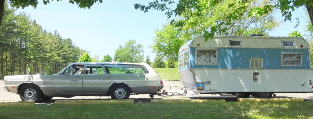

Here is a link to the hitch I made for Jezebelle, a 69 300. I designed it to be detachable and it also bolted directly to my 69 Fury suburban, I towed a 2500 lb vintage camper thousands of miles using it.
Trailer hitch
Trailer hitch

Here’s the bumper hitch I said I would find in the barn that came on my 66. Pretty light duty And maybe only good for a utility trailer or smaller boat Etc.

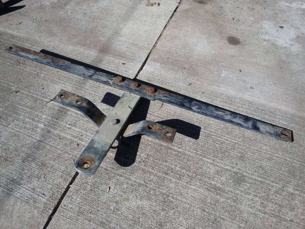

Speaking of trailer hitches... I just came across this on Craigslist and it's NOT MINE! so don't PM me.
Late 1960s Plymouth Fury Class II hitch - $35 (Florissant)
See if I have the link, oh here it is:
Class II hitch - auto parts - by owner - vehicle automotive sale
Might as well post the text, they may not know what they have either.
This was on a late '60s Plymouth Fury, towed a 2500# boat. It could likely be adapted to another vehicle. Good condition.
Cash only, local only.
post id: 7111941764
posted: 2020-04-21 20:19
