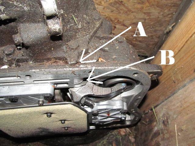

On my son's 70 Fury and my 73 Suburban, the transmission had a persistent leak at the back near the tail-shaft. The pin for the rear-band anchor on both cars was leaking. The pin is sealed with two O-rings. On the wagon, I removed the pin and installed two new O-rings and sealed with a a bit of RTV. On the 70 Fury, it was more of an on-the-fly repair. Generously doused with carb-cleaner, air dried, and spread RTV around the circumference of the pin, then added a round piece of Rubber gasket, sealed with RTV. Other possible sources of leaks are the adjuster screws for the front and the rear bands, and the cooling line fittings.
