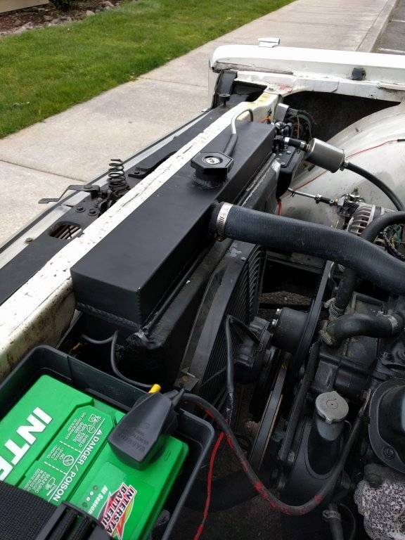

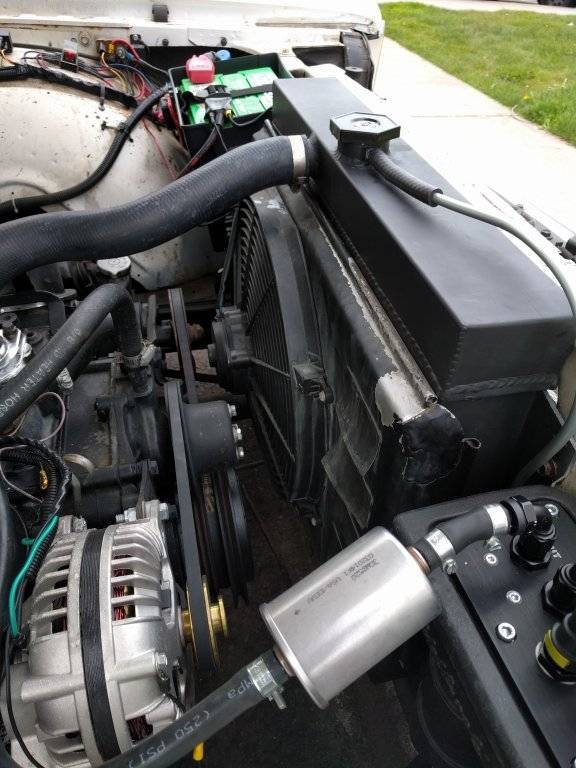

Got her done today. Pretty easy to get the trans lines to fit. I did however drill holes in the mount for the upper bolts. Otherwise fits pretty okay. My fan/shroud combo looks horrible and depending on that cools in the summer will be replaced too. I also took out the 160° thermostat for a 180°
Can you close the hood? I mounted a Champion like that (drilling new upper holes) and ended up having to lower it to the upper holes they had and drilling new lower holes.

That's the first thing I checked haha. Yeah, closes just fine, it's not any taller than the original.
Got her done today. Pretty easy to get the trans lines to fit. I did however drill holes in the mount for the upper bolts. Otherwise fits pretty okay. My fan/shroud combo looks horrible and depending on that cools in the summer will be replaced too. I also took out the 160° thermostat for a 180°View attachment 121906View attachment 121907
