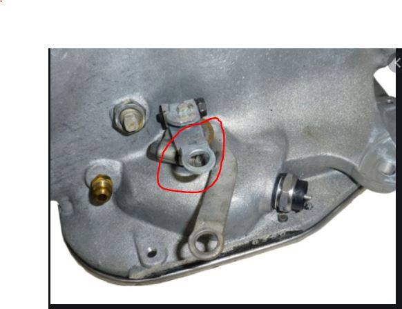

    Good morning,
    my trans is leaking and I was just wondering if it´s easy to replace the gasket there and especially whats THE NAME OF IT Unbenannt.JPG that I know what i am looking for.
    Just did Oil change and filter change and after I fired it up it´s leaking there (marked on the picture, not my trans, just for showing). Hope its just a gasket and I can fix it while trans IN the car.
    Thanks

    Ultra Nice! That’s was I was looking for! Thanks Luigi164✌

    I've done it in the car, it's tight, but doable

    The higher you can get the car the better! Good Luck

    Also, there is a seal on the little shaft, going into the big shaft

    And this isn’t included in these kits with the tools ?

    What tools? Just need pick, small screwdriver and socket set, no special tools I'm aware of

    I think he meant advice?

    The tool kit the creator bought at eBay with the cylinder that screws in the seal and lifts it up with the thread . To change the seal without removing pan and/or valve body
