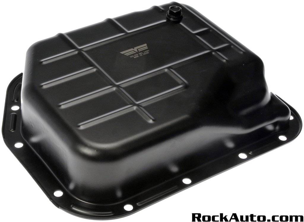

When I serviced the 904 in my Swinger I replaced the pan with a deeper one from a later model overdrive. It was thicker gauge than the original, has a drain plug, and extra fluid capacity. I used a new style rubber impregnated gasket that seals well. They make them for 727's as well.
