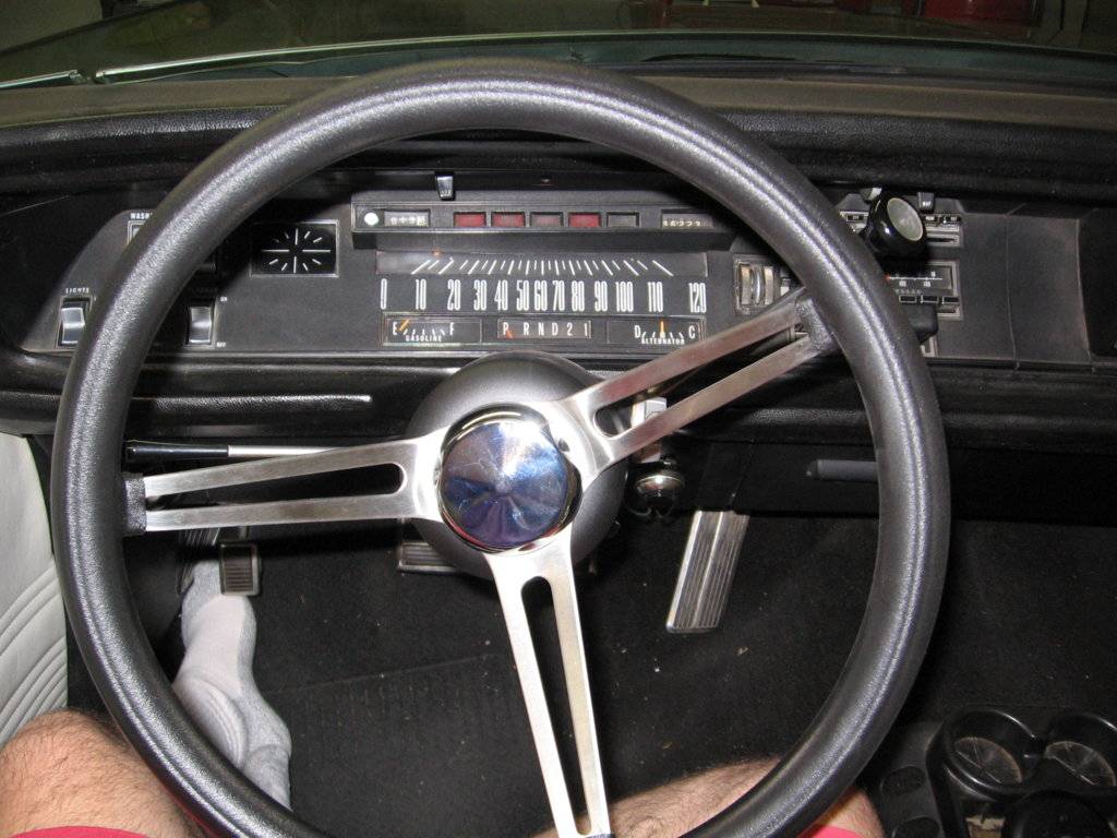

Hey all, of the last several months I've been experiencing an interesting issue: my starter often does not want to turn while in "Park." I put the key in, turn, and nothing. Acts like a bad battery. I put it in "Neutral" and viola!
Now it's becoming common that if this happens, even while in Neutral I need to jiggle the shift a little, then it will fire.
So, what is wearing out? Or, is there an adjustment I need to look at?
Thoughts?

I gave thought to the neutral safety switch, but it seems to be clearly working. The problem is it does not seem to know what gear I am in.
Thanks all.
No, it will not start in Park, and often even in Neutral. When it won't turn over in neutral I have to jiggle the stalk; then it will.
