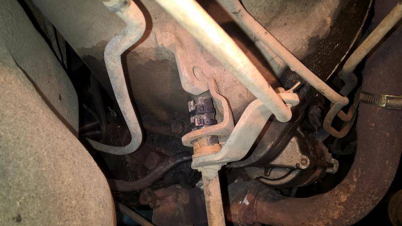

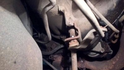

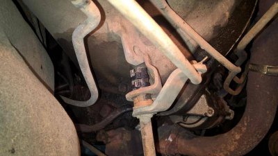

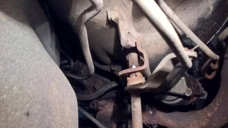

Was it by chance this bushing? It's toast. Until I can get my hands on a new one I just split a piece of rubber hose lengthwise and secured with a couple zip ties. Works well but not 100% Knowing this car I wouldn't doubt it also needs an adjustment. Thanks again for the advice and sorry for the sideways pics.
It looks like your linkage needs some work and if that doesn't fix it adjust the second gear band. Something very easy to do and when out of adjustment creates the same problems. Samething happened on my van only the wedge at the end of the bolt fell out and it wouldn't shift from second to third without letting off the gas, then you have to drop the pan and valvebody to reinstall.
got a 1/2 bolt that bolts to the case under this tang. be careful this bolt is bad for breaking off in the case. if you can don't mess or try to take out when fixing bushing.if have to look for this when you put a early model case or trannie in a late mod. car. there is no place to bolt this bracket too
