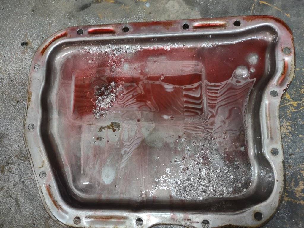

Got back to the house, went from drive to reverse and i thought the trans was gonna fall out. Im hoping its kust the flex plate, but im done gor today.

Sorry to hear. Did it sound like flex plate or mounting bolts broke?

Runs good forward and reverse. Change gears from forward to reverse while adding fluid and sounds like everything is floating around inside housing and banging on each other.

Dont know. Noise seem to come from rear. I dont know a lot about transmissions but maybe its torque converter.

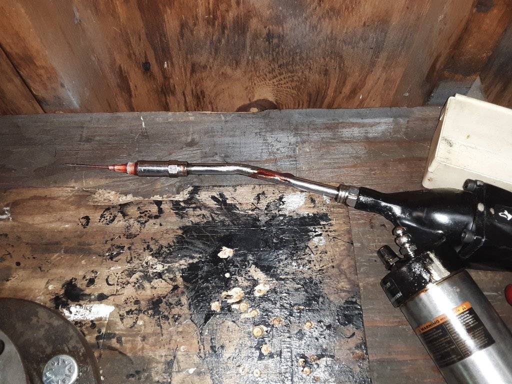

My rear is a 2.76 and everything looks perfect. Took out axle bearing and adjusters and didnt take pumpkin apart. Replacing seals and gasket.
Needle fitting works best for me to lube axle bearings, but lube and seals won't fix your noise.
I think the noise transitioned from the transmission along the driveshaft.

sounds like everything is floating around inside housing and banging on each other. inside the diff. housing? so you got the diff. out and didn't find any metal but didn't take the pumpkin apart. so the pumpkin is out just not apart? if the noises you heard were coming from the diff., you very likely would have found an issue already by just by having pulled the diff. (pumpkin) out. my first guess would have been bad spiders but again they are clearly seen with the diff. out. have a transmission funnel? stick in the dipstick tube and listen into it like the end of a trumpet while the noises are happening.
