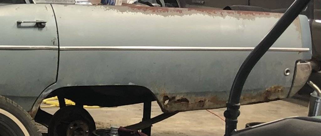

Due to their unavailability, I am considering acquiring a 2 door lower quarter panel to use on my 68 4 door hardtop Fury.
It would appear that it should work forward to the door opening.
Has anyone done this or might be able to point out issues with doing this?
Gee. . . I would think four-door quarter panels would be more plentiful than two-door panels. Doesn't seem right to cut up a two-door panel for a four-door. . .
i believe 67 is different...grabbed a 67 rear wheel arch molding from a yard and it didnt fit my 68...
the lower accent line that goes thru the wheel arch...my convert has it but on my buddys 68 wagon that line goes straight front to back and passes over the wheel arch completely...i think the 67 might be more like the wagons setup with the higher accent line
