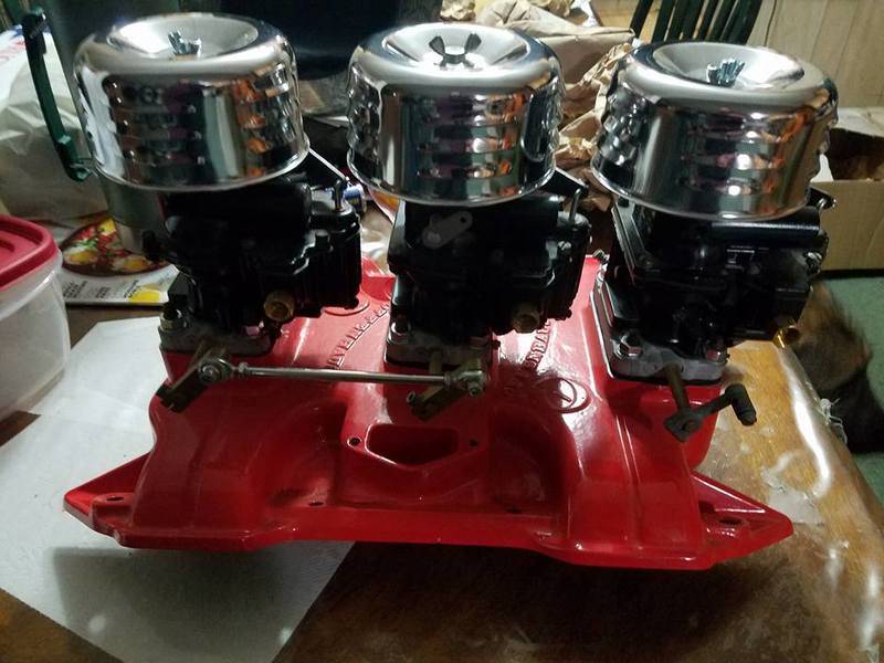

Has anyone ever used the old offenhauser tri power setups. I think they look good and alot cheaper than a Mopar six pack.
I think if you ask enough people familiar with any of the six pack set ups that you will learn that they are hard to tune and even harder to stay tuned. Yes, they look cool but IMHO you would be better off with a single 4bbl carb. If you have to have multiple carbs, go with two 4bbl carbs.

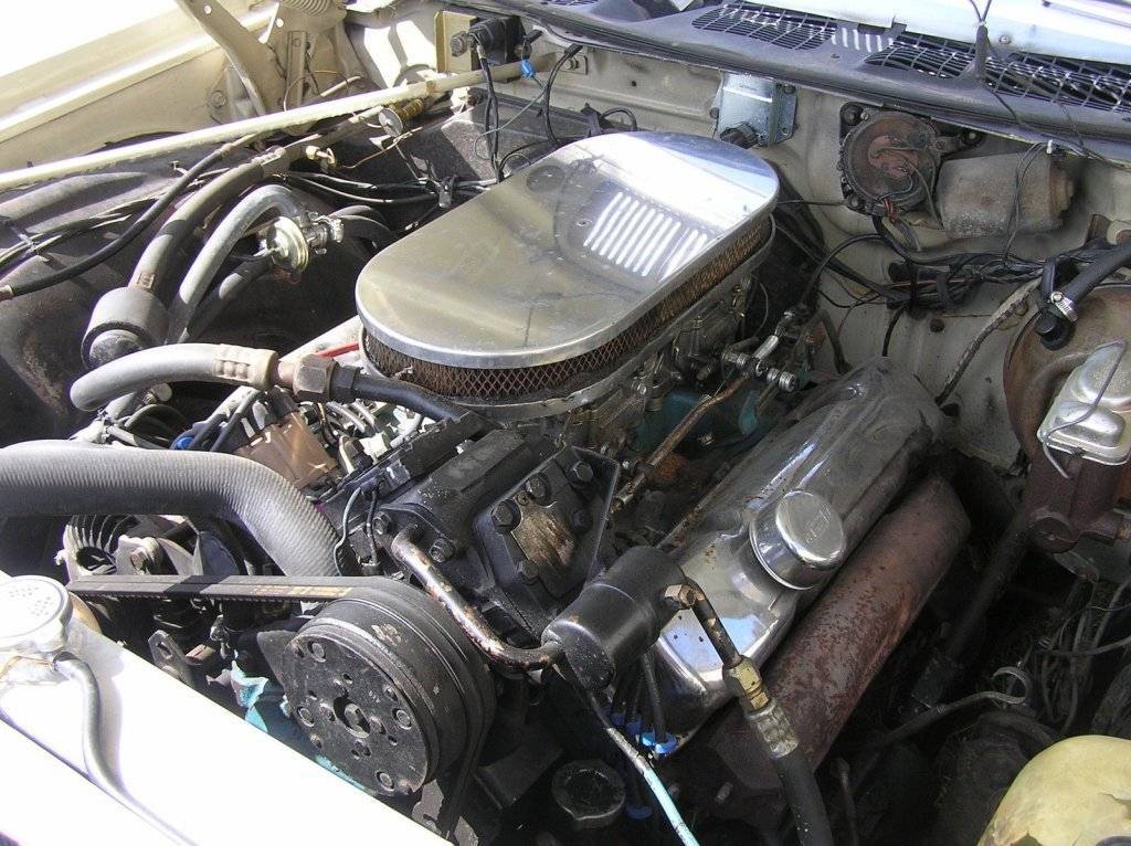

Ironwolf nice pic and a question. Where did you get that vaccum operated heater control valve??
Everyone is taking apples and you may be posting about oranges.
The Offy setup was Stromberg 97, Holley 94, or Rochester 2G carbs with a mechanical linkage. Nothing like the six barrel/six pack OEM Mopar setups.
I'd stay away from it myself. This was 50's tech. Old carbs that you aren't going to get parts for etc. Performance will be most likely dismal at best.
IMHO, the appearance would only look "right" in a nostalgic custom or hot rod. Not a C body.
Damn hard for me to keep abreast of modern hot rodding now because it evolved at a pace that was basically too expensive for me. But I overheard a few guys convincingly explain that there are 4 barrels today that outperform any dual quads of the sixties or any 6bbl (in any configuration. 6x1 or 3x2. I don't care) setup.
On a good day the setup John pictured would get 600 cfm.
