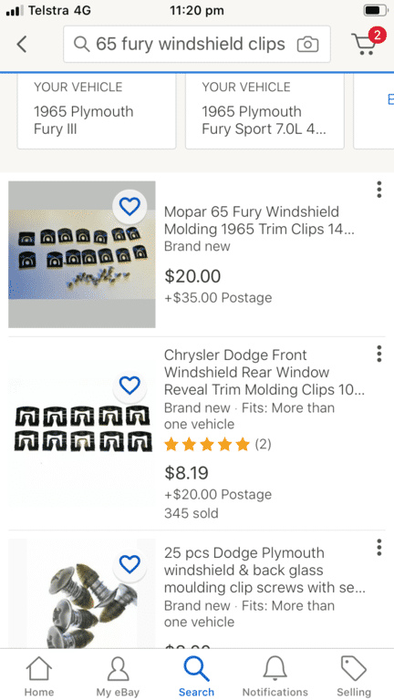

Hi Guys,
I am removing front and rear screens when my New Yorker goes in for paint, what is the correct clips for the stainless molds around the front and rear screens, including the lower one on front screen.
Are the ones pictured correct ??
Also how many do i need.
Regards
Gavin.

When you get your screens out,remove a clip from front and rear for reference.
Guessing now is OK but not the best idea.
The front ones should be the same,however the rears can be different depending on hardtop or sedan.
Depending on year,make and model,there were some mid year changes,etc to some window trim and clips as well.
Au-ve-co makes the clips which are supplied by majors parts stores.
But being in Austrailia,they do ship internationally.
Here is a link to their site and check their FAQ regarding international shipping and on line catalogue..
Homepage
Dealing with them directly takes out the "middle" man so I hope they treat you fair in pricing.
Hope this helps
eBay but depends on what model you have.
