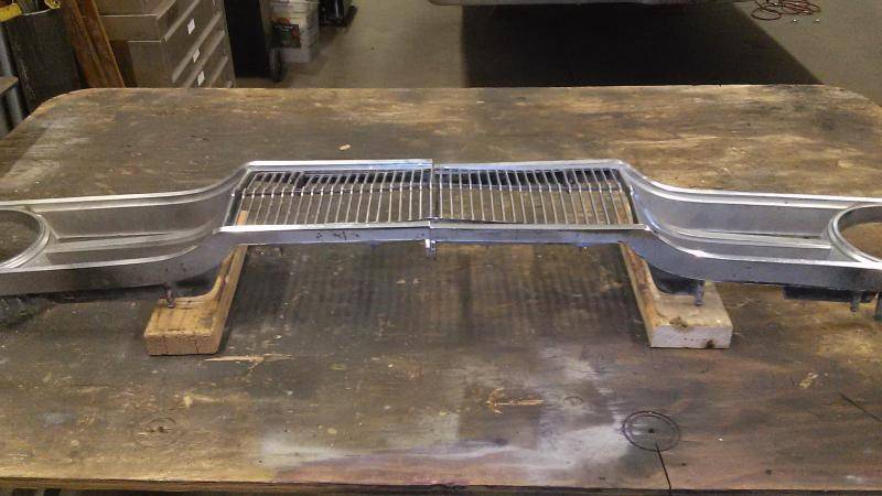

IMG_20150723_082612.jpgGood Morning! Well the dreaded day of the 68 Polara Coupe Restoration is here! What can be done to refurbish this piece? I've found some sites of Professional restorers but I'm not looking for Concours Quality! lol! With a mixture of Silver Argent kinda fogged onto Chrome? Have any of you "Spray Gun Jockeys" out there had any success in refurbishing items like this?
It is not chrome. It is anodized aluminum.
Buff out the shiny part.
Argent the non shiny part.
Clear coat everything.
Don't clear coat your aluminium, it will corrode under the clear coat.
If you don't care about the car,...then go for it. But you will ruin the piece.
Thanks! It's hard to tell where the Anodized leaves off and the Argent goes on? Some parts of the Argent paint look "Feathered", with no natural lines. Looking at a site now on you tube about restoring Dodge Chrome Trim and Argent Painting Exterior Trim and Wheels.

If the anodized surface is good, just shine it up with your favorite polish.
I like this stuff.
If the anodizing is in rough shape, then you need to strip the anodizing, buff and polish. Have it anodized if that's in the budget, otherwise you can just keep polishing it from time to time.
Never heard of clear coated quality aluminum rims. Just doesn't happen to get that nice pateana ( or however you spell it ). To get a really nice aluminum look you'll have to sand with 1500 wet/dry until you can feel no transitions in the anodizing. Go to a local Sherwin Williams auto paint store and purchase GBP etching primer (grey) and spray on a base coat of primer. This is shear primer and drys absolutely smooth. Next ( and this will blow your mind ) at a quality hobby shop, buy two cans of TAMIYA brand chrome spray paint. The cans are only 100 ml and need to be warmed in hot water before use to up the pressure in the can. Spray on a let dry for at least 48 hours. The finish will almost totally resemble anodization but the final gloss will be determined by the top coat you apply of the same brand (TAMIYA) clearcoat - flat, semi or gloss. Unlike regular clearcoat this stuff is shear like their paint and has no roughness on the surface like regular clear. It'll probably run about $65 to do this but you won't be disappointed by the looks.
A combination of brake clean and XXX steel wool will clean the surface and pull most contaminants from pores/pits of anadized aluminum. Then polish with your favorite metal cleaner/polish. I like "Brite Boy".
