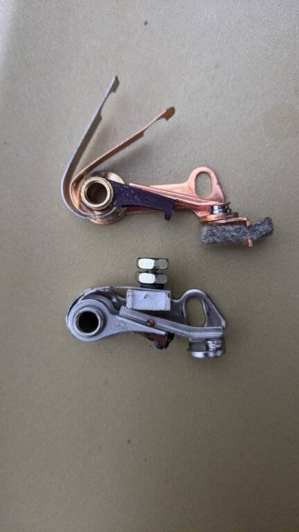

This might be a stupid question but I'm not sure if I got the wrong set of points or if they're just a different style that I can't figure out how to make work. The set on the top is the new one. As you can see it's missing the insulated mounting bracket with nuts that the spring strips attach to along with the two wires. Is this the wrong part or is there a way it make it work? For the life of me I can't figure out how to make it work.

View attachment 424264 This might be a stupid question but I'm not sure if I got the wrong set of points or if they're just a different style that I can't figure out how to make work. The set on the top is the new one. As you can see it's missing the insulated mounting bracket with nuts that the spring strips attach to along with the two wires. Is this the wrong part or is there a way it make it work? For the life of me I can't figure out how to make it work.

Top set is for a dual point distributor or maybe an old IBT unit. The bottom set is what you want. Go shop for some CH15V points, and be SURE to get a good condenser with them. I strongly suspect the lack of these two crucial elements is what keeps your engine from reliably running. You probably should get a new coil also. Rock Auto is good for new coils. Get a Standard UC12 or UC12X. Black, dirty plugs are plugs not getting enough spark to burn what fuel is on them.
Your FSM should have enough detail on how to install the points properly. If you've no previous experience with this Art, find an elder who has. No need to be ashamed either. MOST Folk nowadaze have never touched ignition breaker points.
One neat thing about Chrysler B/RB engines is how easy it is to remove the distributor and put it back in. It is many times easier to pull the distributor so you can put it in a holding fixture (as in a vice attached to a sturdy work bench) so that you can make sure you get the TOP of a breaker point cam lobe so that you can get the points set correctly. As for the setting, not really different than gapping a spark plug, but with a flat feeler gauge rather than a round wire. In the case of the feeler gauge, making sure you get it aimed FLAT to the points' contact surfaces and not angled slightly (which can affect the gap setting). IF you want to be more accurate, then you might set up a dial indicator to do this.
Of course, make sure which way the distributor rotor is aimed when you take the distributor out, so you can put it back in in that same orientation.
It's not that hard once you have done it a time or two.
BE SURE to smear some distributor point grease on the breaker point cam lobes! Essential to getting 15K+ miles out of a pair of points, as we did back when points were all that was OEM production equipment. That felt on the one set of points can do the same thing, with a drop of oil to moisten it.
