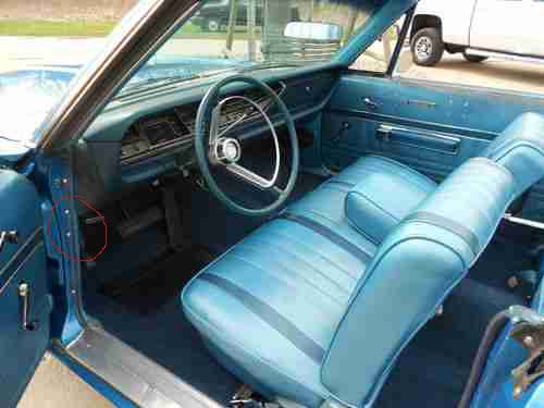

What car are we talking about? If it is the one in the photo (70-71 Fury?), check the top of your front fender, there is a bracket there with a bolt in it. This bolt goes into a threaded appliance that is spot welded onto the top of the firewall. Sometimes with age the spot welds break and a crack forms that allows water to run in. If the leak is up high and dripping down on the dash, the sealant on the windshield is bad and needs to be reset. If the threaded part is loose or cracked, usually it can be sealed with some RTV.

its a 68 Fury. No vinyl Roof. I dont have any water leaking into the trunk it looks like but the trunk seal looks like it could use some replacing. To the issue with water coming into the front area drivers side, i can see it dripping from the plastic trim piece by the door, it must run down from high up somwhere and then it collects on the edge of the trim piece next to the dash and drips onto the carpet. I could not reprocude it with a hose, so i assume it happens slowly when the car is outside in the rain and it seeps through.
Pic is from google!
The A-pillar leak is probably the windshield, have a pro reseal it. I would remove the rear window trim to check the channel and make sure there is not a pin hole allowing water in the trunk.
