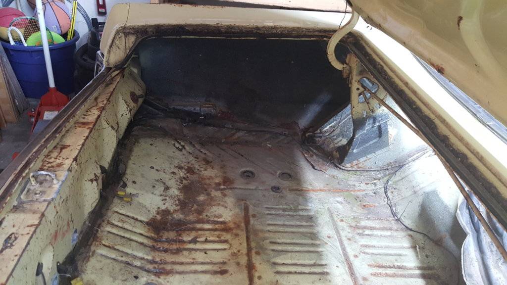

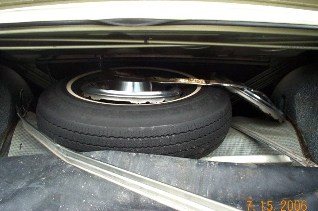

I don't have all the experience that Bill has, but my 1970 Fury was consistent with what he said. I got the impression that they tried to give a good cover on the inside of the fenders and the inside of the wheel wells, and the spray on the trunk hinge mounts and at the rear of the trunk was just sloppy overspray from moving the gun from one side to the other.

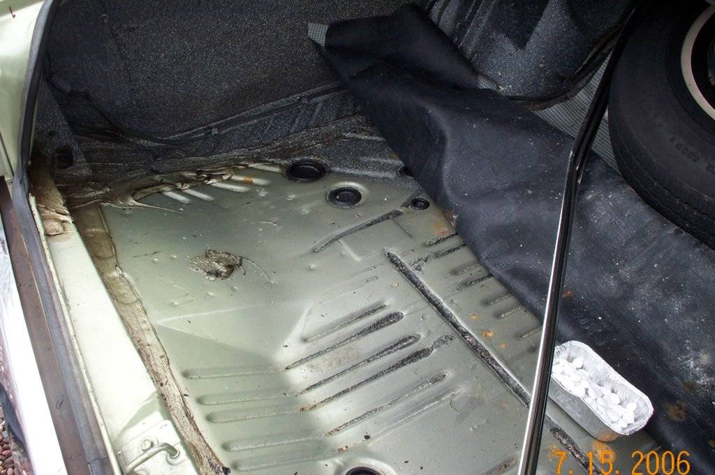

Thanks guys... makes sense based on what I've seen. My Polara indeed will be done exactly this way including the clear coat...

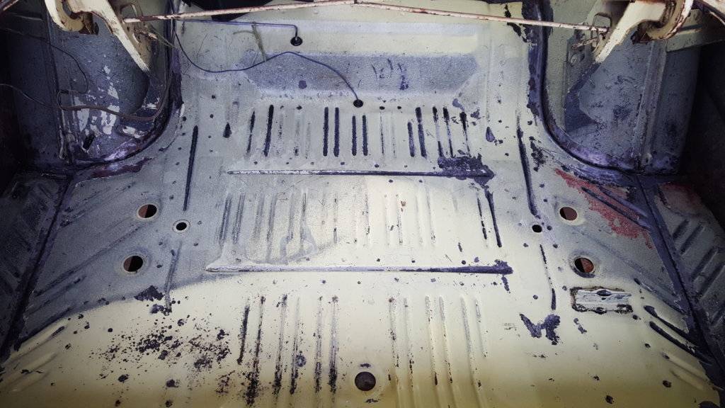

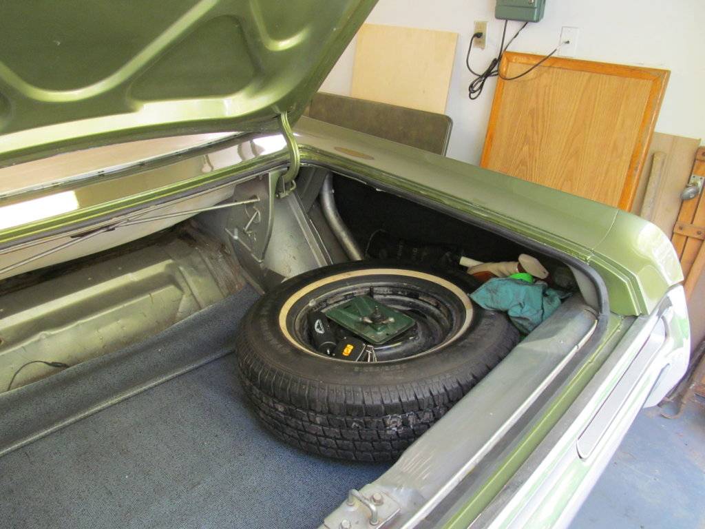

This pic just popped up on another thread. @Snotty 's car. No spatter paint. My car (70 300 vert) didn't have the spatter paint either, but I don't have a "before" pic of mine.
I wonder if it is an option? I would call it a sound deadener more than spatter paint. It is a textural material sprayed onto the inside of the fenders and oversprayed elsewhere. On mine, it is peeling off in big chunks. I wish it wasn't there at all. On my build sheet, there is a "5" in the undercoat/hood pad box under miscellaneous items.
The only thing I could think of is if the car had the trunk "dress up" option, where there is black cardboard over the wheelwells, it might not get painted.
That option wasn't listed on my broadcast sheet though.
The other theory is that some just got skipped. Will's 69 300 didn't have the front black out paint applied to the radiator area, so some these things might be skipped.
