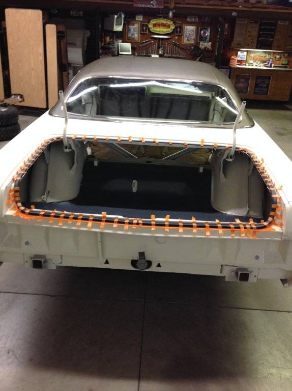

Thought I would pass on some tips.I agree that the black adhesive is the way to go.I put some masking tape just to the outside of where the seal is going to go to keep sealer off the paint.Apply sealer to trunk brush out with small brush.It should be a thin coat.Next put a small bead on weatherstrip.The sealer should be tacky on trunk by now.Once the weatherstrip hits the tacky trunk adhesive it’s a done deal.You can do a foot or so of the weatherstrip at a time to make it easier but be carefull to not get adhesive on paint it’s tough to get off.

I used a ton of masking tape & the clear 3M weatherstrip glue.
