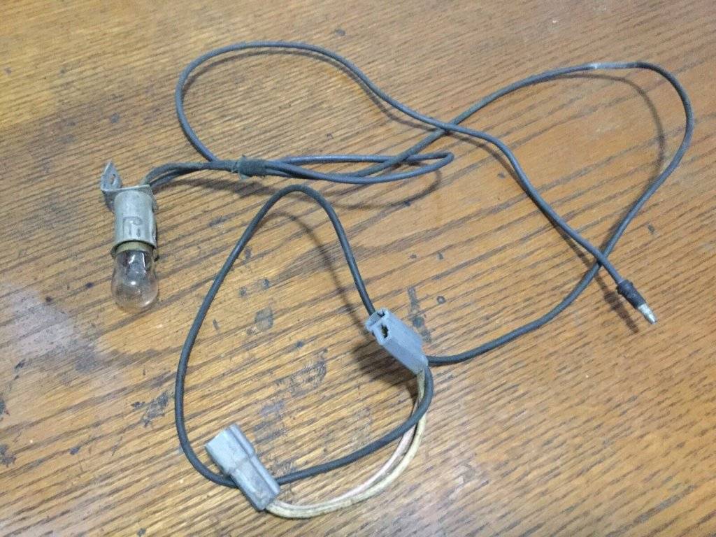

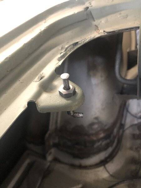

Does anyone have a clue what this part of the trunk is for?
If you look at the wiring harness just below that you will see a connector, that is where it plugged in. This light was an option, not all cars had it.
Alan

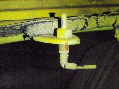

What do you mean by a switch? Inside the car? There is no switch. When the trunk is closed it compresses the "plunger" on the top, and interrupts the flow of juice to the light, thereby shutting the light off when the trunk is closed. Open the trunk, the switch pops up and the light goes on. Pretty simple. Cam Shaft

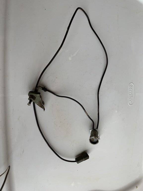

There are two different trunk lights
If it mounts in the trunk and not on the lid it will use the switch.
If it mounts on the lid it most likely will not use the switch as it has a mercury switch built in.
Mercury Switch, light on lid.
Plunger Switch

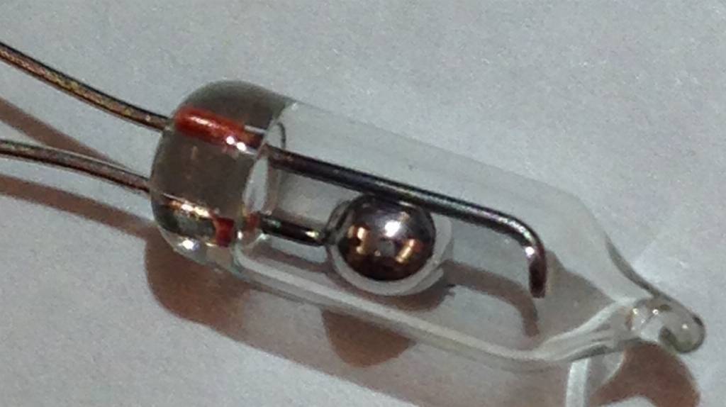

Some cars (don't know what you have) will have a Mercury switch built in that makes contact when the trunk is lifted.
While this is a generic mercury switch, it shows the operation better than I can explain it. When it tips, the ball of mercury (which is conductive) rolls down and covers the 2 contacts.

Cool. Thats what i have and works good. Mine is on trunk lid
