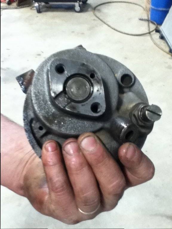

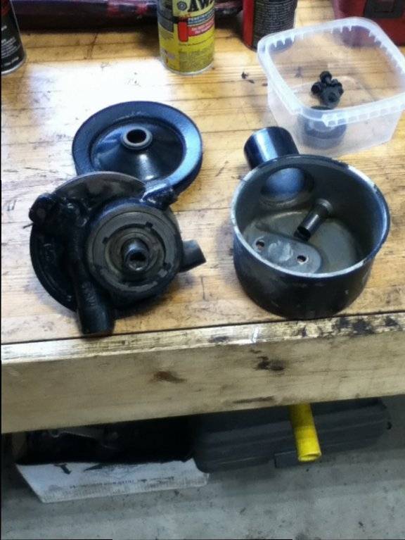

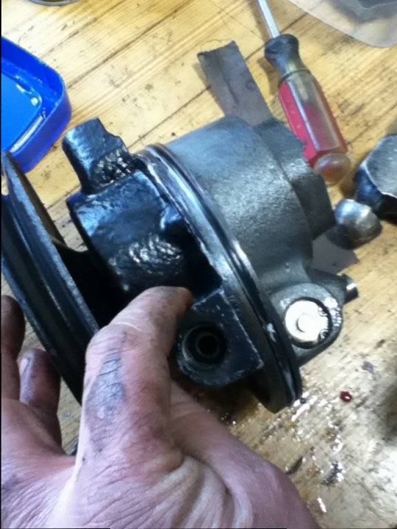

The p/s pump was leaking on the sporty so I removed it disassembled it and got a seal kit.

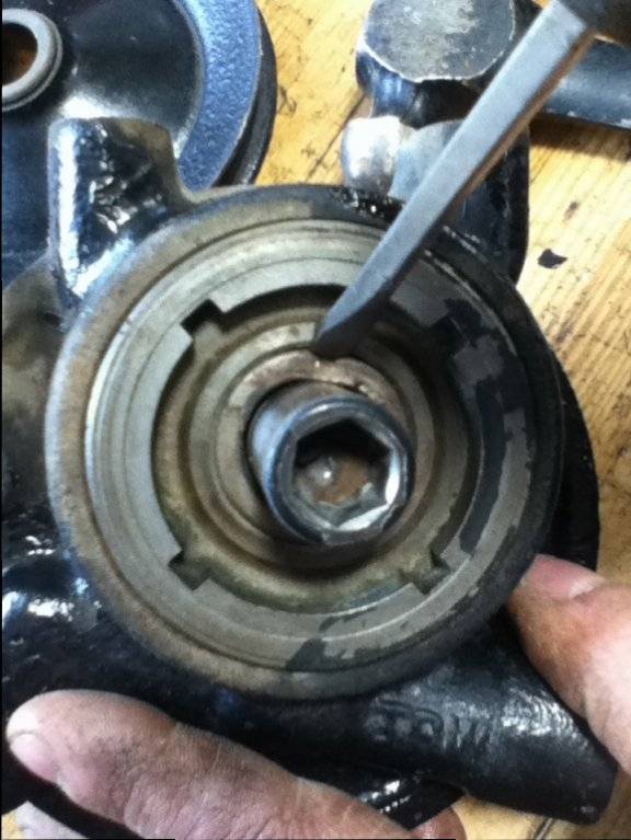

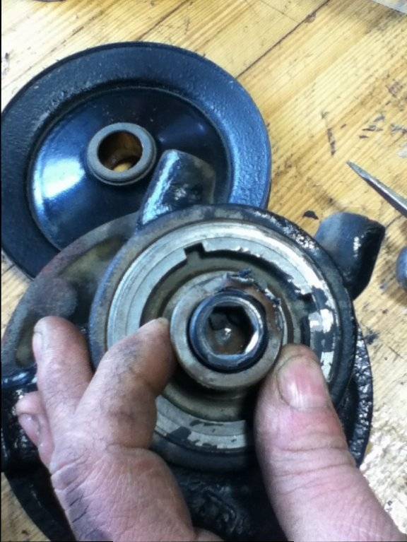

I first removed the pulley with a puller then I went after the seal. There is a indentation next to the seal and used a punch to crush in the side of the seal.

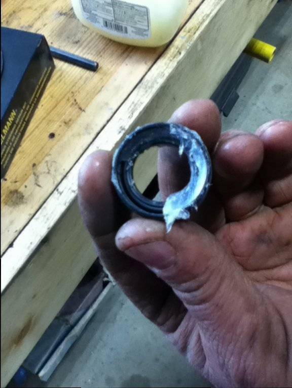

Then I used a screwdriver to remove the seal

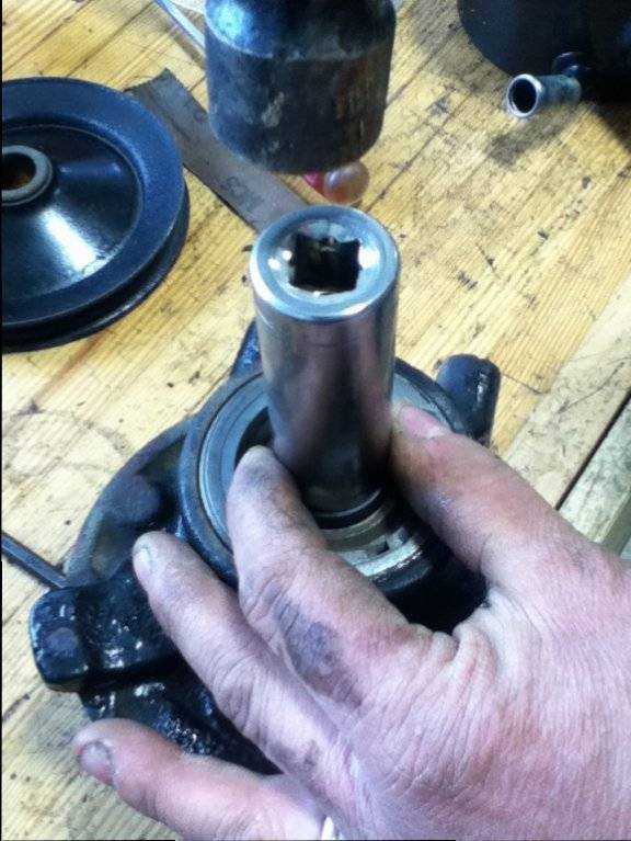

The seal install was next, I always pack the spring with grease so it doesn't pop out when it is driven in place. I used Vaseline for the seal, and a socket to drive it in with

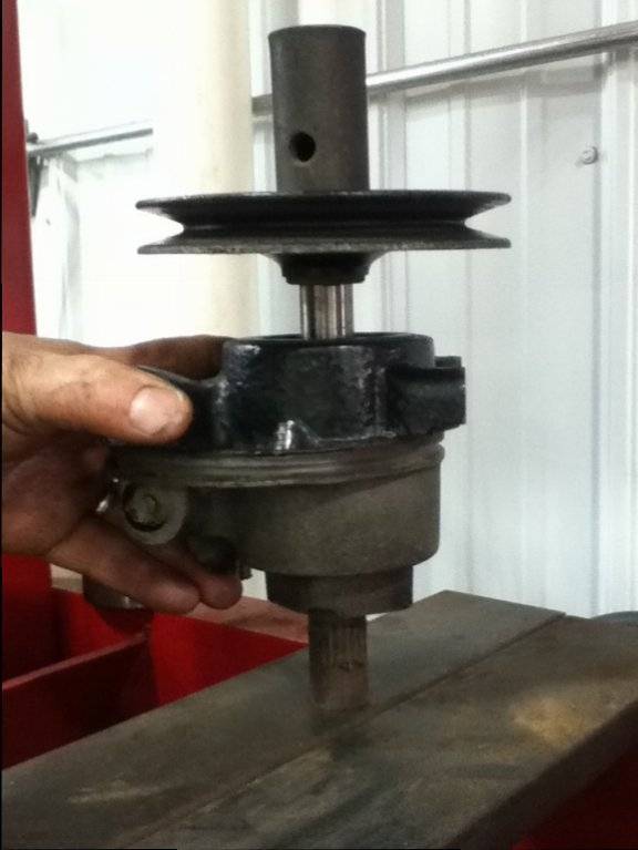

The pulley has to be pressed back onto the shaft. I used some round stock against the back of the pump shaft to support it.

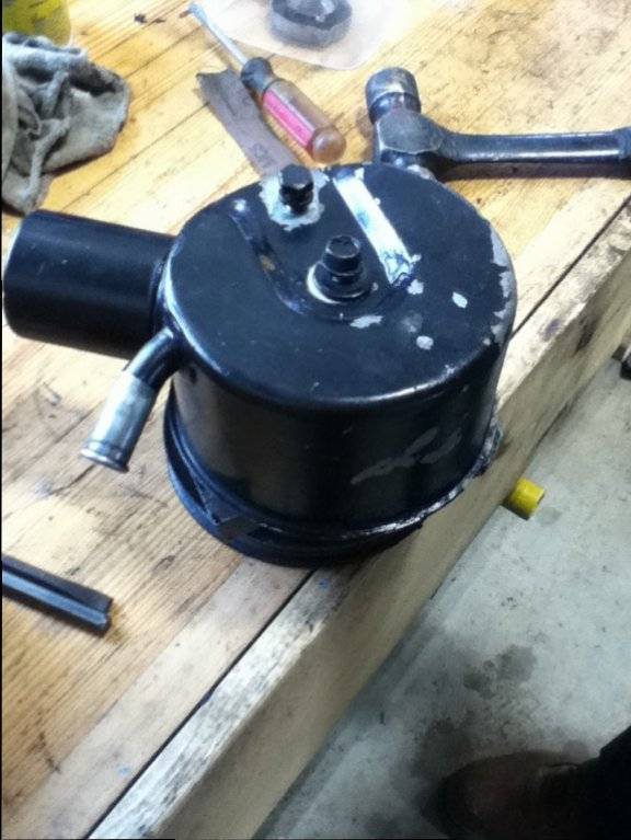

Then the o-ring for the pump body is next lubed with more Vaseline.
Then I lined up the tank and pressed it into place by hand.

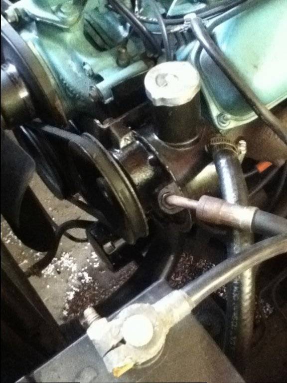

Reinstall the bracket, than I put it back on the car.
Here it is back on the car

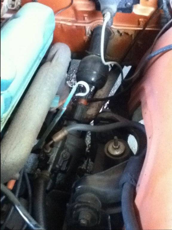

In another post there was some question about the angle on the steering shaft on a 66 fury. The 65 has a slight angle to it also.
