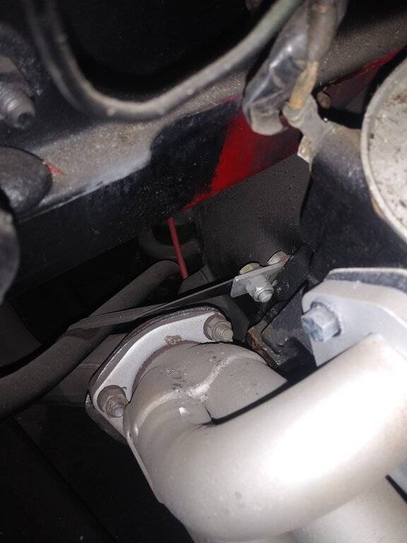

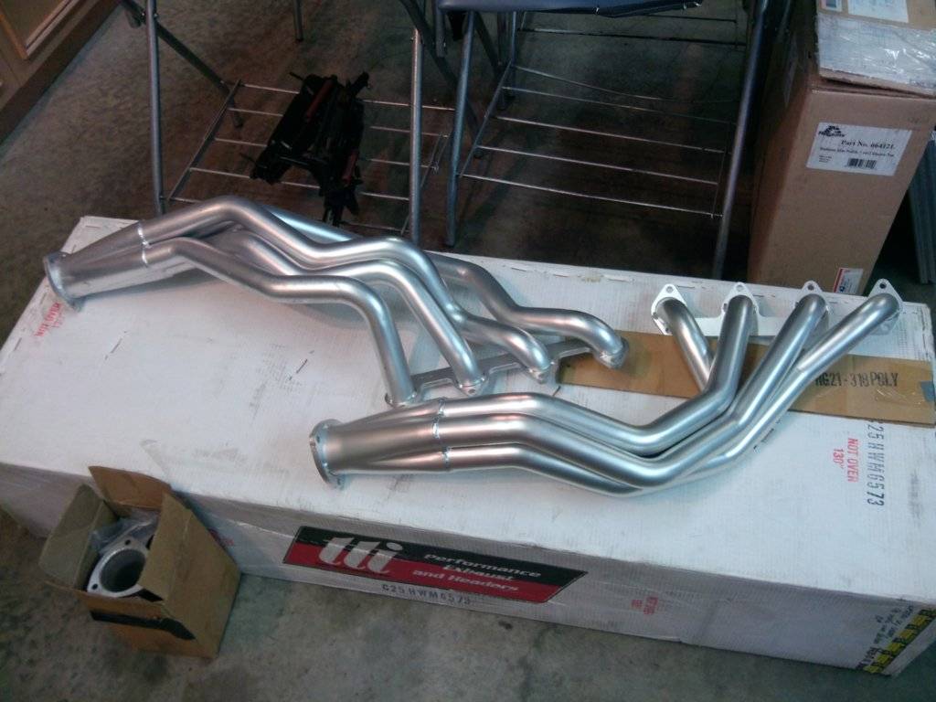

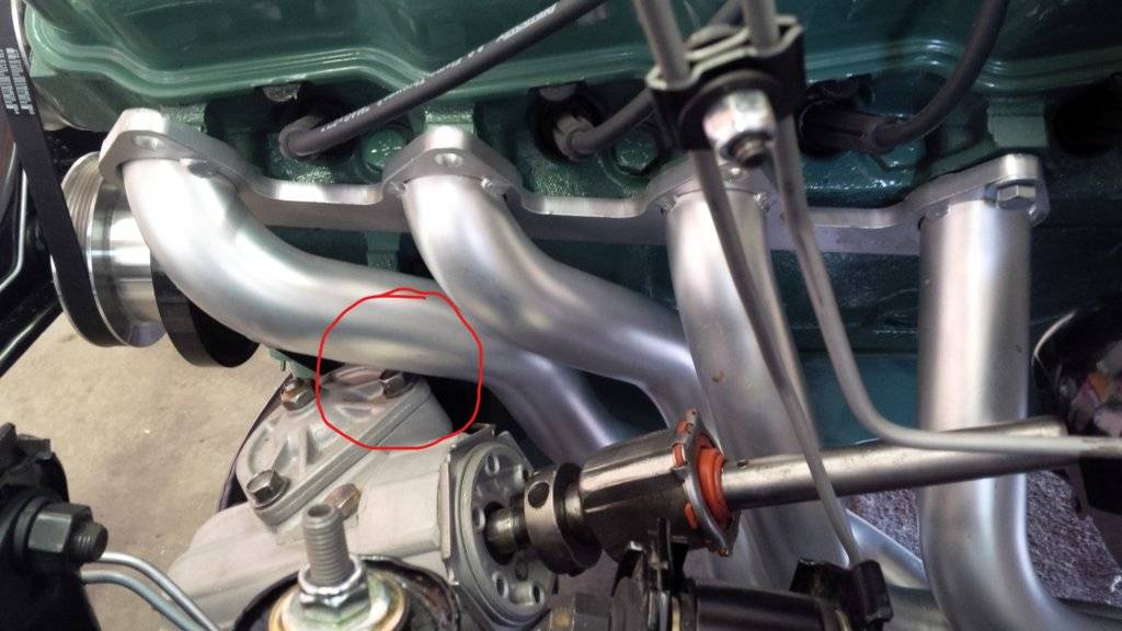

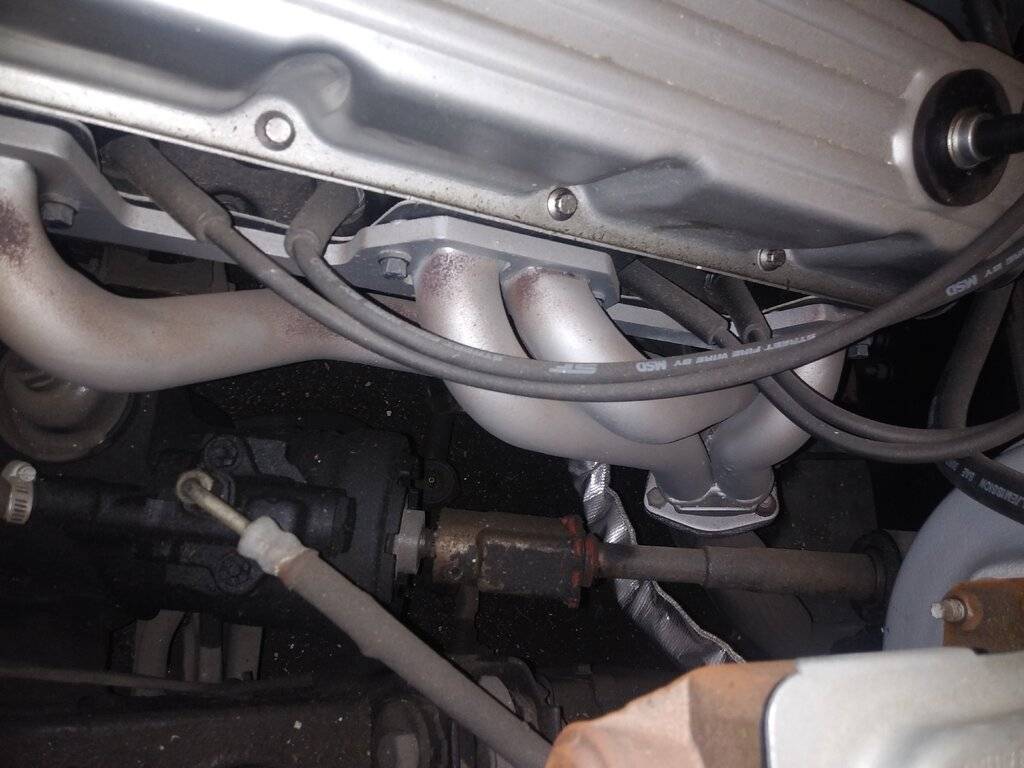

I have TTI headers on my Poly. Bought them in about 2013 or so. A word of caution if you have manual steering, the steering box sits higher than the PS box so the left header wouldn't quite line up without hitting. TTI sent me a B body header for that side and that cleared the box and worked fine.
As received from TTI
Wouldn't line up.
Hit the steering box. Manual only supposedly the PS box sits lower.
They sent me this one.
And all is well.

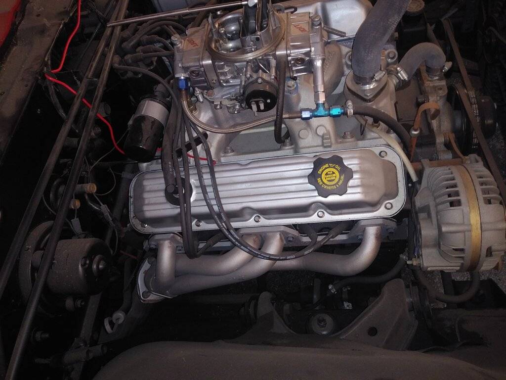

Hello everyone, the sanderson DD-7 fits great and does not hit anything. You will also be able to weld pipes to the collectors ends with enough space left over so you dont cook starter or hit any torsion bars. Only Con is losing some H.P not having long tube headers, PRO- no dents from beating them to fit. Sweet fit great sound I love them.
I bought the plain steel. Sanded and painted them with Eastwood Ceramic coat silver good for 3000. Degrees couple years old paint job still looks great.
Used about 4 cans many thin painted layers built up eastwood products have been great for me.
Free endorsements.lol
One additional side note about the sanderson headers they tell you you dont need a gasket...lol
I used remflex gaskets for no leaks.

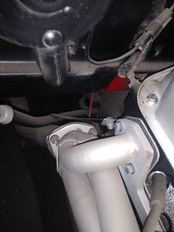

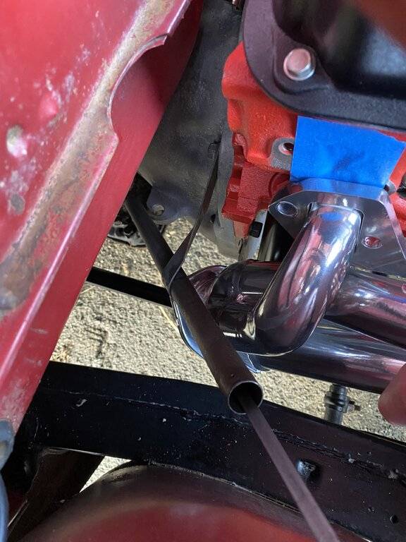

@BigBen what did you do with the dipstick tube. I did a quick mock up hold and it appears the dipstick won’t allow me to lift the back of the manifold up enough to install
Please no harassment over dirty engine
Windshield heat cracked havent driven it for months.
I hope the pictures help
If i remember corre3 my friend used a tubing bender down near the block end of tube to get litte angle just cleared the header. I posted a picture
Hope this is helpful

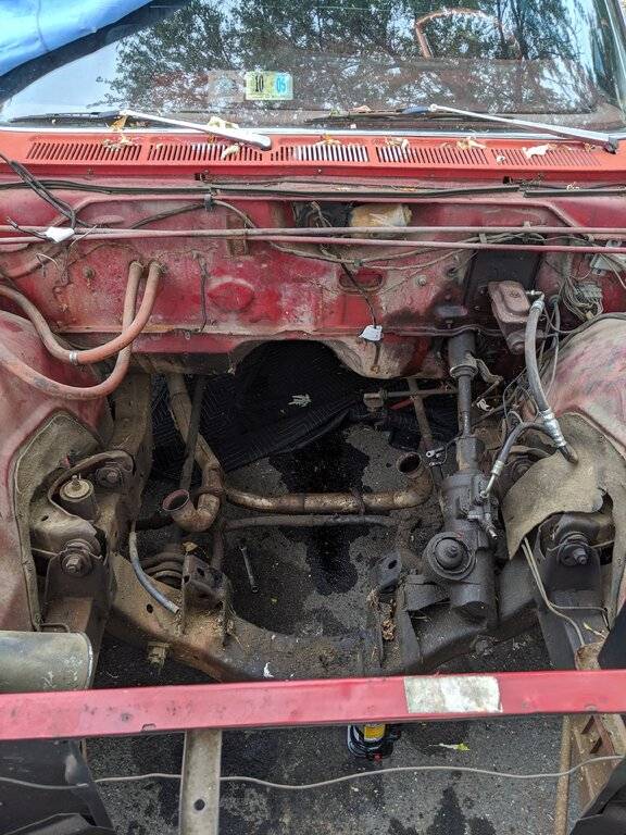

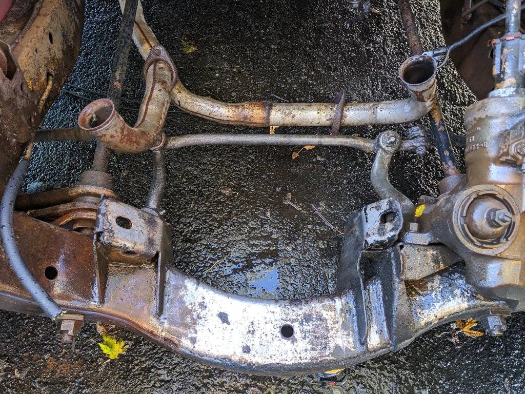

@BigBen Last question about your exhaust hopefully. I moved the transmission dipstick and installed the starter. I held the headers up to see if everything would fit...all is good. My question is, did the exhaust shop you use run your midpipes inside the torsion bars or outside the torsion bars. Looking at my pictures from removing the engine, I see the pipes came off the manifolds inside the torsion bar, then moved to the outside. Just wondering how the exhaust shop did yours.
The shop I used angled the pipes in towards the drive shaft and went along the drive shaft connected H pipe and then angled them back over to area under the back seats for the mufflers and then back towards the drive shaft and then turn Downs in front of the rear wheels
