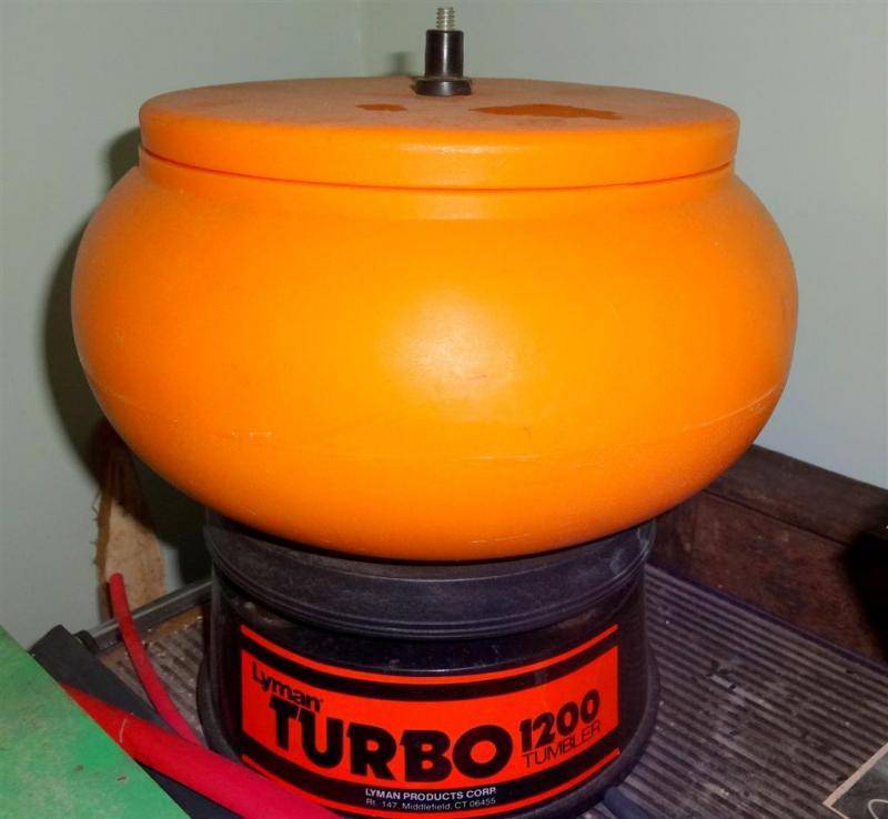

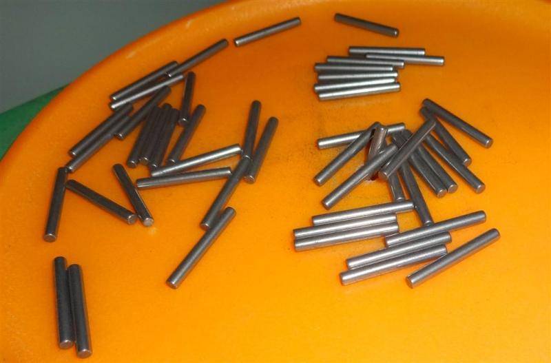

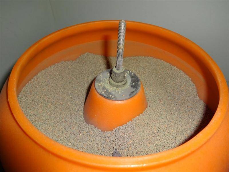

This is my tumbler. Works great. I use walnut shells for the more delicate parts and the stainless shot for cleaning hardware and small stainless trim.
It takes a day in the tumbler to really work well, so plan ahead.
