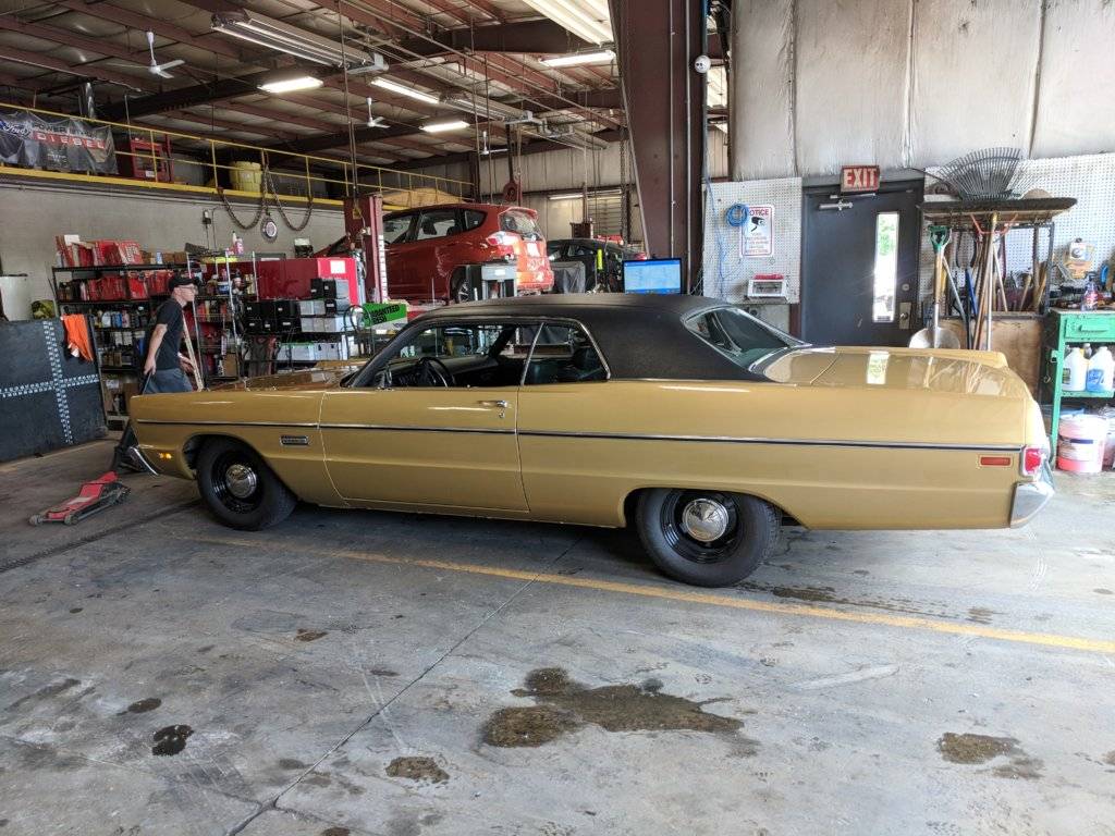

Sorted out timing and vacuum advance with my points on my 440. She has never run better.
It is now in the mid 80's and I am getting a bit of detonation at part throttle but not all the time. Dwell is 29. The base timing is at 12 to 13 * btdc. I am running a Edelbrock 1406 with stock jets and metering rods I believe. Should I backoff timing first or should I try richer metering rods by one step first, or something else? . I know the 1406 tends to be lean. Plugs look good.
Hate to back off timing as she idles and runs great in cooler weather and when hotter too except for the slight pinging.. But I realize you got to do what you got to do if necessary. Any thoughts would be great to point me in the correct direction.
thanks
