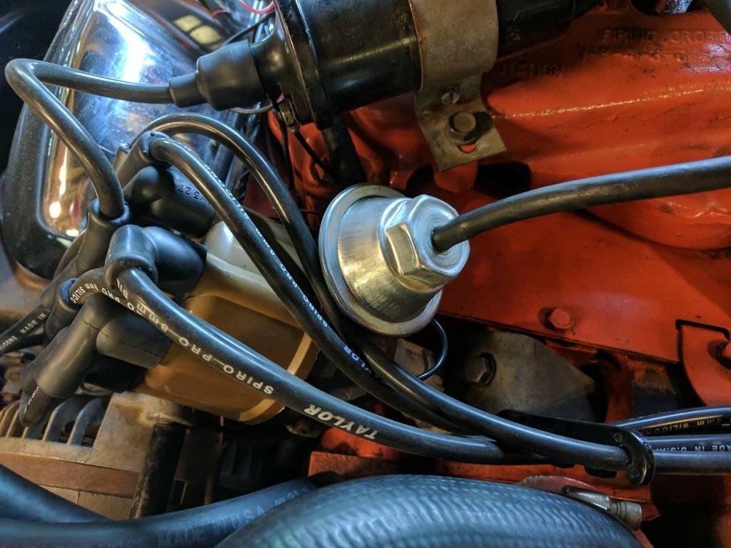

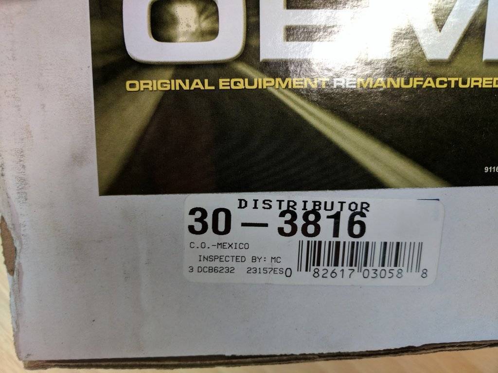

My Fury hasn't been her self this spring so I got out the dwell,vac, and feeler gauges to check things out. Idle was low and not running smooth even after I raised the idle . Anyways got the aircleaner off and was going to install my vac gauge on the line to the dizzy. Just to be methodical I pulled a vacuum [me]on the line to the dizzy and was very surprised the vacuum canister in the dizzy would not hold a vacuum. I just put in the dizzy last summer. Interestingly if I applied pressure to the line it would somewhat hold. Weird. I am assuming that is the old gal's problem with no vacuum advance and a vacuum leak. My question is where can I get just the vacuum canister and which one should I get?? Below are pics of the piece of crap and the part number [cardone number] .
Any info would be great and thanks as always.

I have had no luck finding one for my car. Called Cardone to try and get one since it was rebuilt by them with a new canister. Called Standard Auto Products and they said they don't make them. Called Mancini racing and they carry no points style vac canisters. The rock auto ones I think are for electronic ignitions as the arm looks different. I'll keep looking...

Thanks for the reply. I have been tearing out what little hair I have left trying to find a supposedly easily available part. I called Cardone as it is a reman part with a NEW vacuum advance canister. They couldn't sell me one, and they couldn't tell me the part number either. They just didn't have the info. They even called me back after researching it with no real answer. One solution would be to return the whole dizzy under warranty they said as I bought it last August with a 1 year warranty/ but geeze WTF?? I got a few other options in the fire now and will let you know what I find. Wish me luck,,,,,

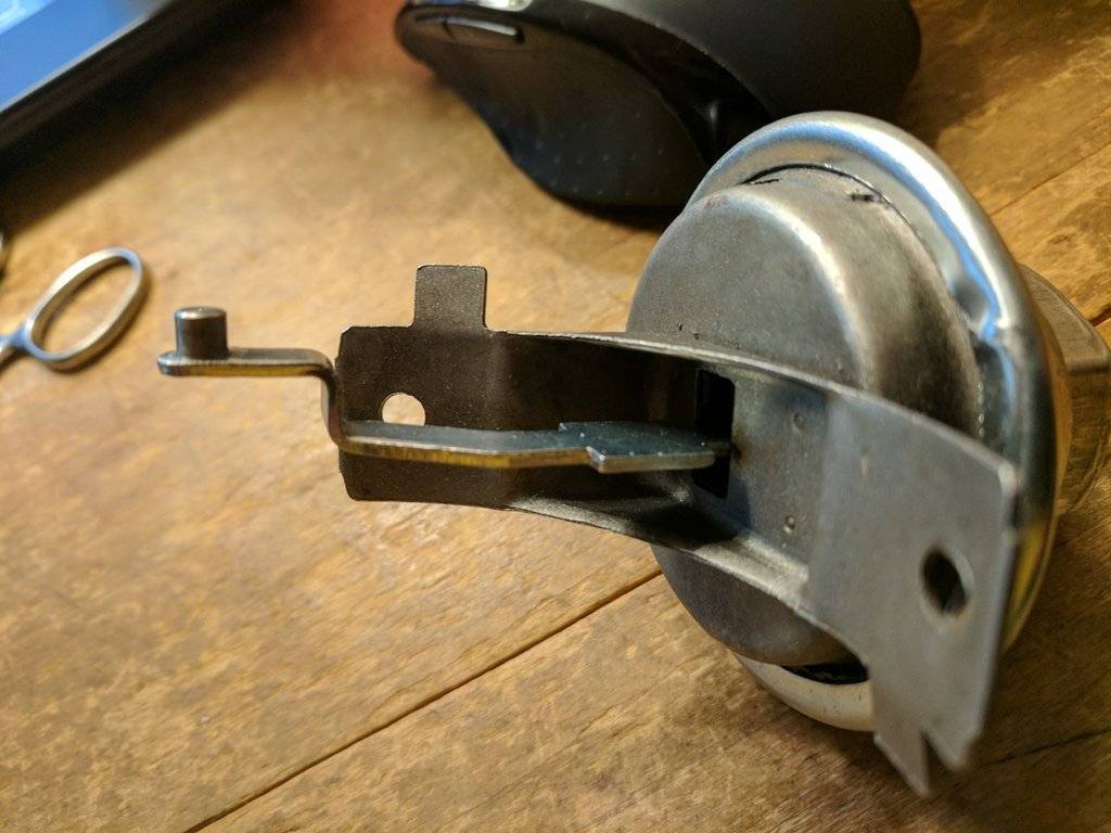

Thanks for your post. I see you have really researched this and we all appreciate that.. I believe it is not the canister itself but the arm that attaches to the distributor which is much different. I don't know why they are so rare. here is a pic. It goes under the plate not over. I hope someone with more knowledge will chime in or enlighten me. I have been told that such canisters like this go for big bucks on ebay. I found none that look like this on Rock Auto or anywhere else.
Small block VC will not work, dist rotation is opposite.
Turboomni I ended up redrilling the plate to use the plentiful electronic VC Whit the arm that points in toward the shaft. One caveat to beware is you will have to file pin down so it does not interfere with the points themselves seating or lift the plate up when tightened. I have not fired my car yet but it operates correctly with hand vacuum. I should know more this weekend.
