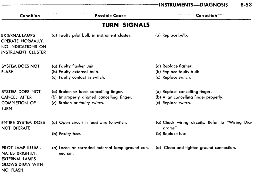

There's a clip that houses the flasher just under the dash by the ashtray at the lower lip. Do you have the Factory Service Manual? If not, you should pick one up. It's worth its weight in gold.
AnaheimEA
Mar 27, 2020
37
7
Ca
Yes this is the manual I purchased for the car. I know every time I start on something small it gets into other stuff. Lol oh well soon enough the car will be good to go.
