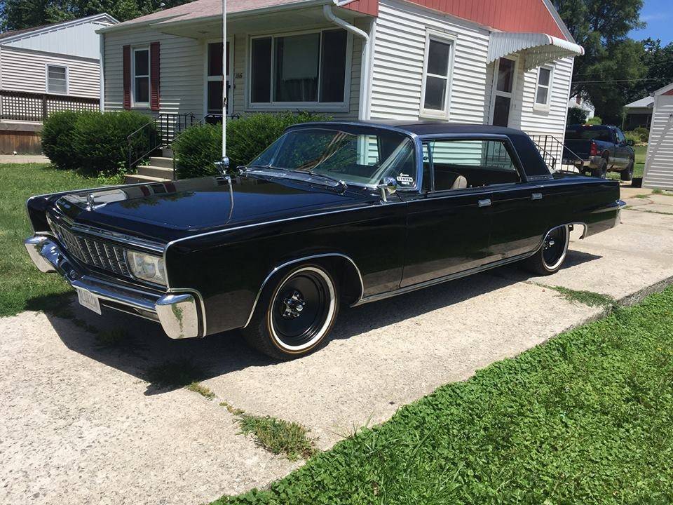

    Stan is past the age of reprogramming and the only correct stance he's referring to is to the factory specs. Most on this site will agree with him including myself in most cases however I do like the way these cars look when lowered. Your car is looking pretty damn good btw..

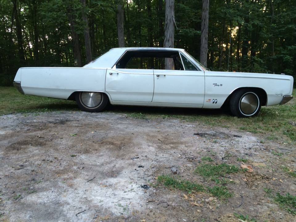

    2" inches should be your limit. Any more than that and you'll be bouncing of of the bump stops , which doesn't feel good! It is as simple as turning the bolts. Although not an imperial it is similar. Here's my 67 fury with 2" blocks in the back and tbars turned down. IMG_1112.JPG

    Put it in the weeds!!

    Young and free!!

    Your car looks great.
