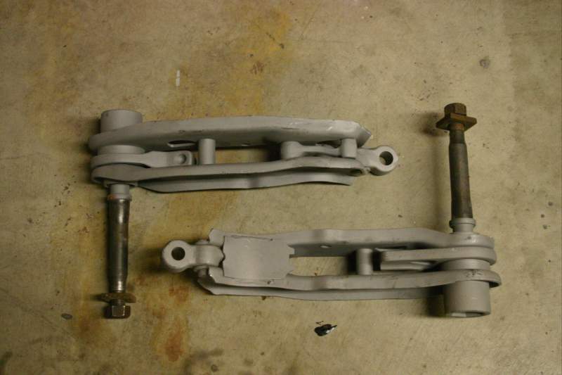

    They are only unsprung when you install them, the second you tie the upper an lower control arms you add some minimal amount of load on the springs.
    The simplest way to look at a torsion bar is to think of it as an uncoiled coiled spring. When you compress (or extend) a coil spring the rod that forms the coil actually twist just like the torsion bar.
    To better understand the torsion bars you need to understand the design of the lower control arm. The socket that the torsion bar goes into is floating in the control arm. There is a lever on the socket that extends into the control arm, this is where the adjuster bolt makes contact.
    [​IMG]
    The pivot/socket is free to spin in the control arm, you can spin it 360, without that adjuster the suspension would just bottom out and sit on the bumpstops.
    Now if the adjusting bolt was on the frame and twist the bar then I can see it loading/unloading the spring but not with the way it is designed.
    Alan
