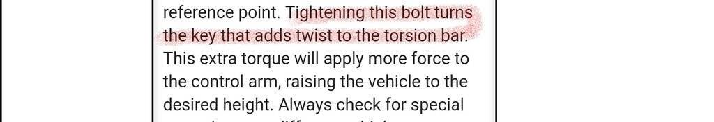

  19. MrMoparCHP
    MrMoparCHP Senior Member
    Messages:
    4,181
    Likes Received:
    2287
    Joined:
    Aug 9, 2013
    Location:
    Lompoc, CA
    Interesting piece, until I see a difference in the twist when I adjust it I stand by my comments. The article is more a piece to describe the ride height aspects but fails in the engineering behind it. Just because it is on the internet it doesn't make it so.
    Even with their example with the adjuster on the frame and not the control arm should have no impact on the twist.
    The adjuster on a Mopar changes the relative position of the arm to the bar, on their example it changes the relative position of the bar to the frame (the arm will go with the frame. On both of these changing the ride height, in the end the TWIST remains on changed, the bar was twisted to start with and will remain with the same twist. This is a property of the weight, change the weight or the bar and you will see a difference in the twist but adjusting within a combination weight/ bar will not impact the twist.
    I need to raise the front of my car so I will be sure to document this.
