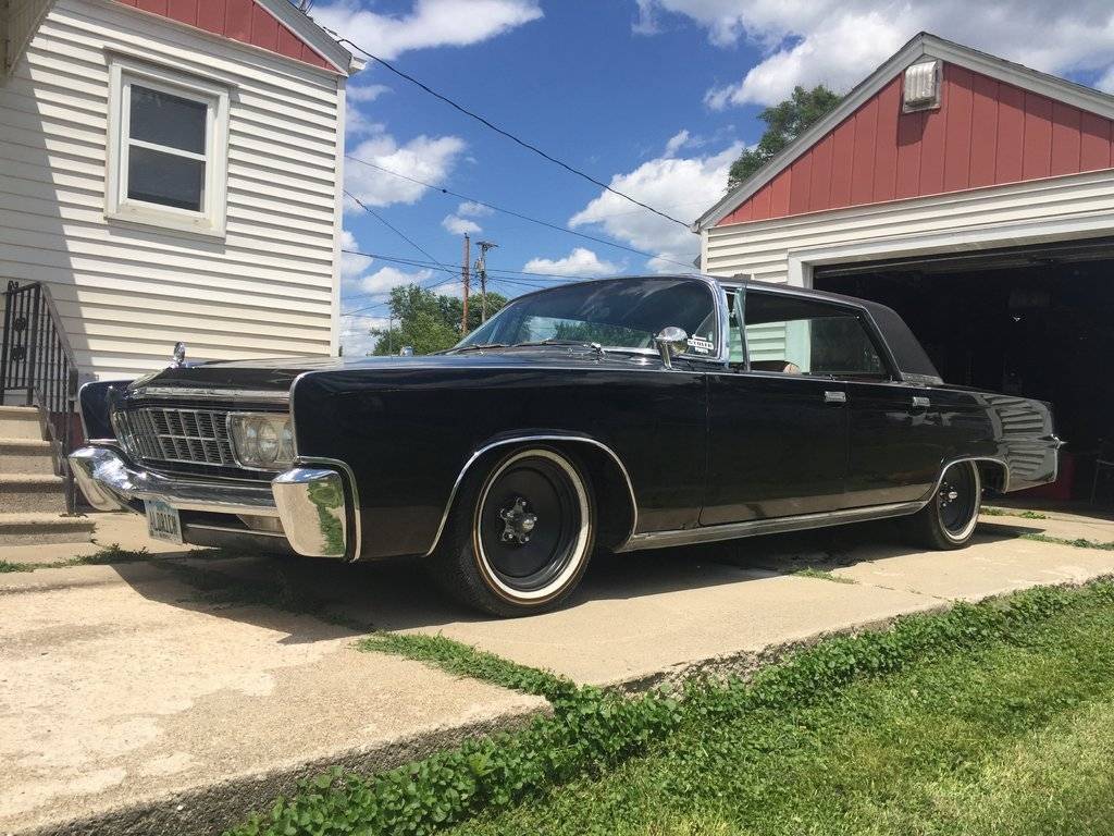

Took 5 out passenger side and 6 1/2 on drivers side, top of front fenders is at 24 1/2 now. Not for everyone but I prefer the look, and rides still comfy as can be

Not my preference, but that car has enough presence to handle it without too much embarrassment.
Not mine either, but the whitewalls make it work.
You're right about presence. Kind of a bad-*** elegance!
