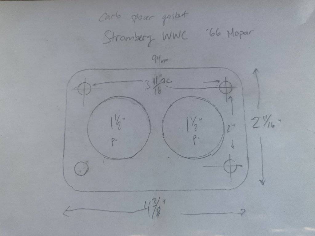

I’ve got the old “fuel boils in the float bowl after 15 minutes of hot soak” problem, so I’m looking for a composite or phenolic spacer for my ‘66 383 with two barrel Stromberg. Must match dimensions as illustrated in photo below. Thanks.
Should be the same dimensions as a Rochester 2GC carb, which can come in 1.56" throttle bores and 1.69" throttle bores. Same as the Carter BBD for 383s, too.

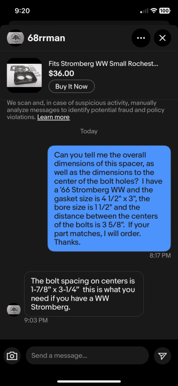

Thanks- I found another spacer listed as fitting "Tri-Power Rochester" 2 bbl carbs for $30. I asked for specific dimensions since they weren't listed. The one from Canton looks to be correct but is almost 50% more expensive . . .
So the gasket I found that was listed as fitting a Stromberg WW is too small. Second time I’ve run into this problem, which is why I’m posting here.

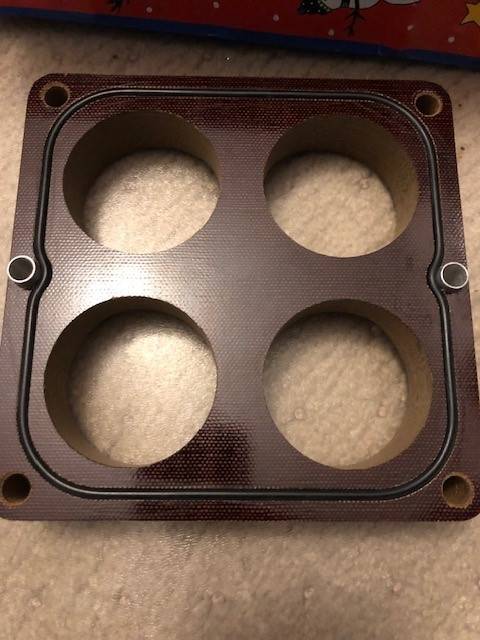

Super easy to make. Take me 30 minutes. You supply the material I can make it for you.
Do you know (or does anyone know) if the 2-bbl stromberg has the same opening and bolt placement as the 2-bbl carter (BBD) for the 318?
It should, but I can probably check later this week. I have both on the shelf.

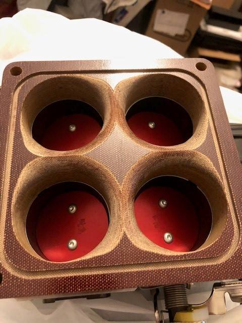

I didn't make this one from scratch (was just a square spacer when I started) but I did the profiling and o ringing.
As you are adding this take note of any linkages - like choke and throttle - that go from carb to intake/block and make sure they will function as intended with extra distance.
I would go with 1/4" material. Phenolic has very good heat insulation properties. Linkages should not be a problem with only a 1/4" spacer.

Yes, there are 2 different BBDs. Larger one is used on 360 and 383. The 318 carb is notably smaller and different in appearance and I believe it has a smaller mounting pattern.
The smaller BBD version was used on Super Sixes also.
