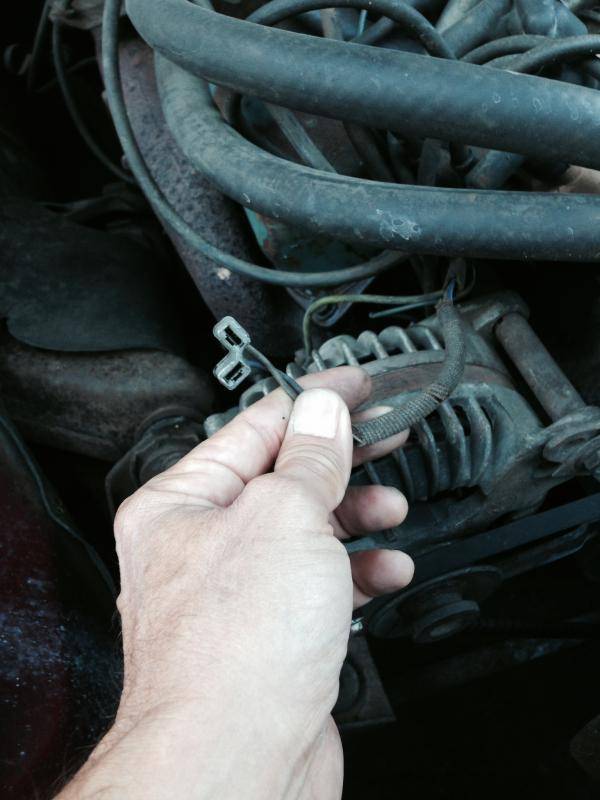

1. How do I know what amp alternator to buy? 35, 45 0r 60? And if I up the amps do I need to replace the voltage regulator?
2. What the hell is this? It's in the same loom as the two wires running from the alternator & it is not plugged in to anything.
Yep, temperature sender.
