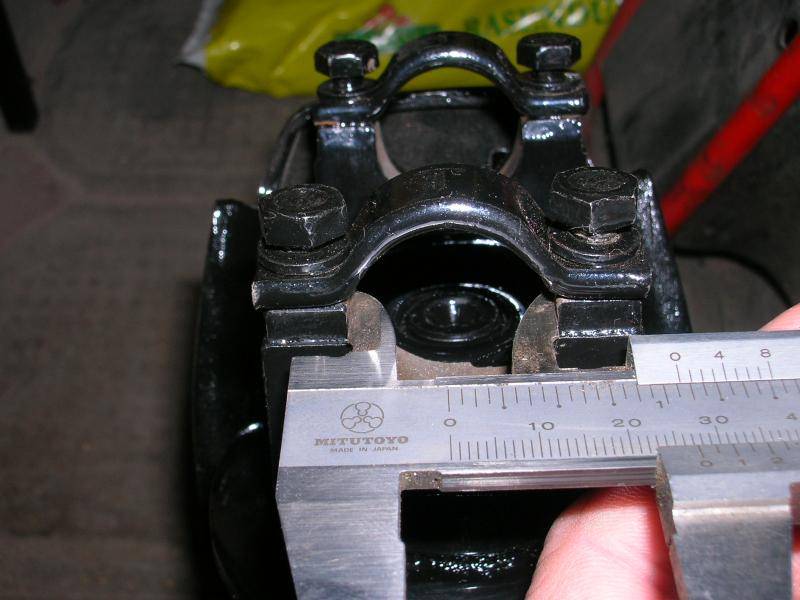

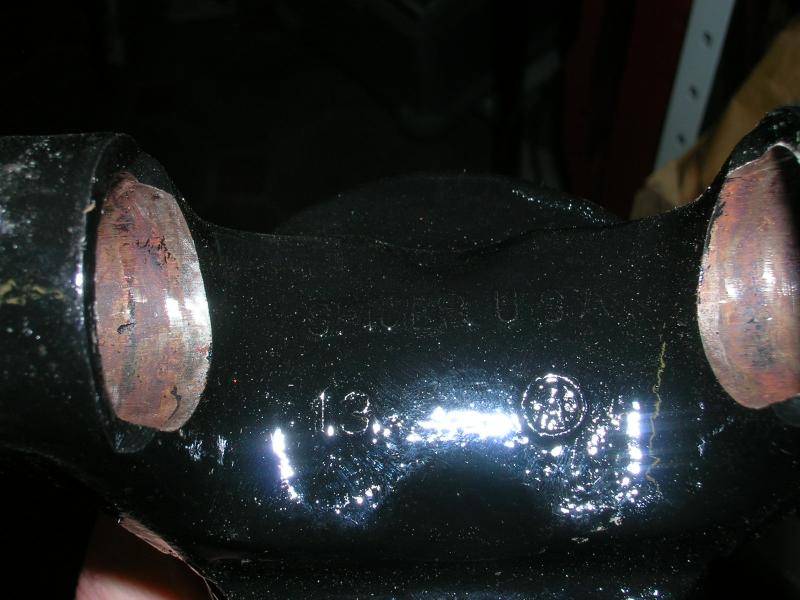

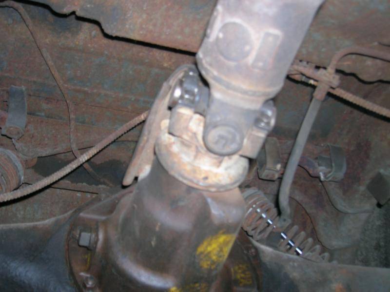

Hi guys!
Just an interesting U-Joint theme:
Mine are NOT 7290(3 5/8") nor 7260(3 1/8"), nor 1310 (3 1/8") nor 1330 3 5/8") , mine are something between:
the cap of the 7290 and 7260 is 1 1/8" diameter, the cap from the 1310 and 1330 is smaller 1 1/16" diameter.
Mine are: 3,5" wide with 1 1/16" caps - original from spicer.
I am not able to find these U-joints.
So I bought 1330 U-joints and shortened the width of them....:icon_silent:
but now it is hard to get them centered at(in?, onto..), the yokes.
Anybody an idea where to buy?
Thank you for your help.
