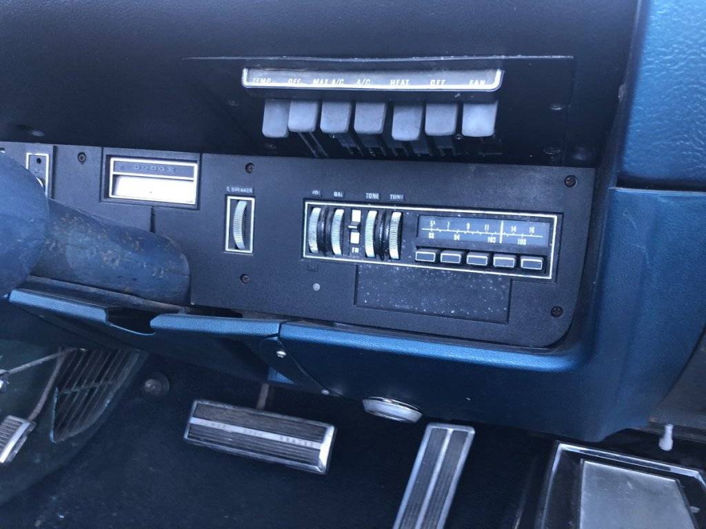

My 69 Dodge Polara convertible has a light in the lower part of the dash seen between the pedals. This was a convertible only thing, on the Dodge there was only one, on the right of the column. It is just a courtesy light.
As for your Chrysler I have no idea where it mounts of if it is even the same style of if there were two.

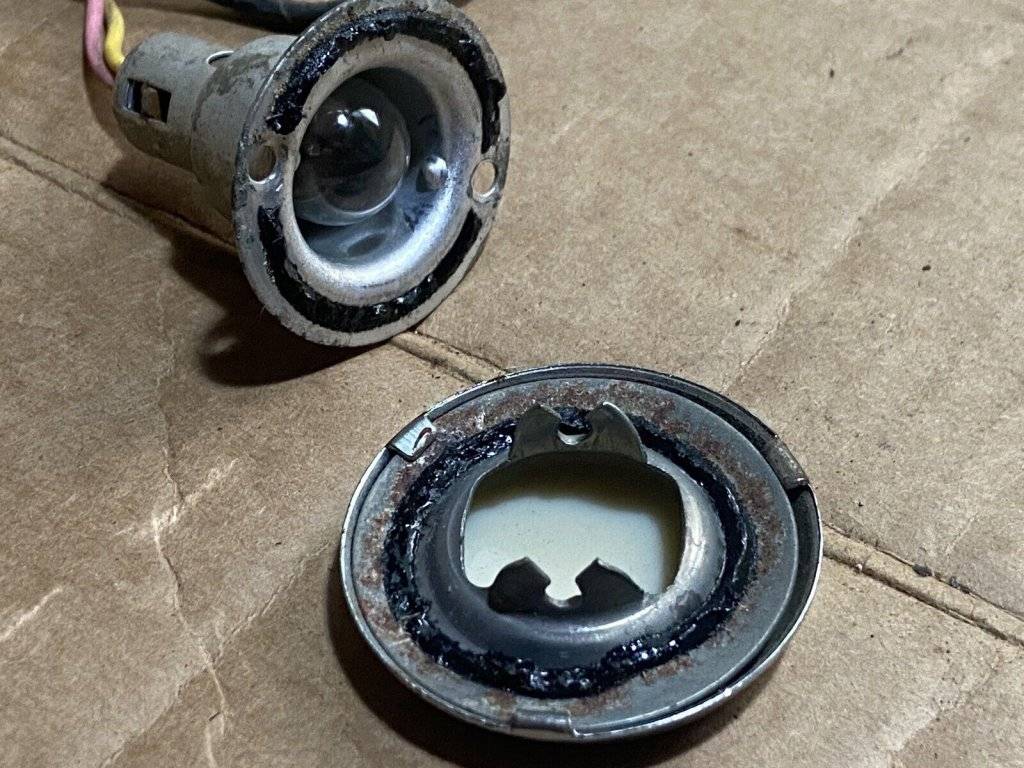

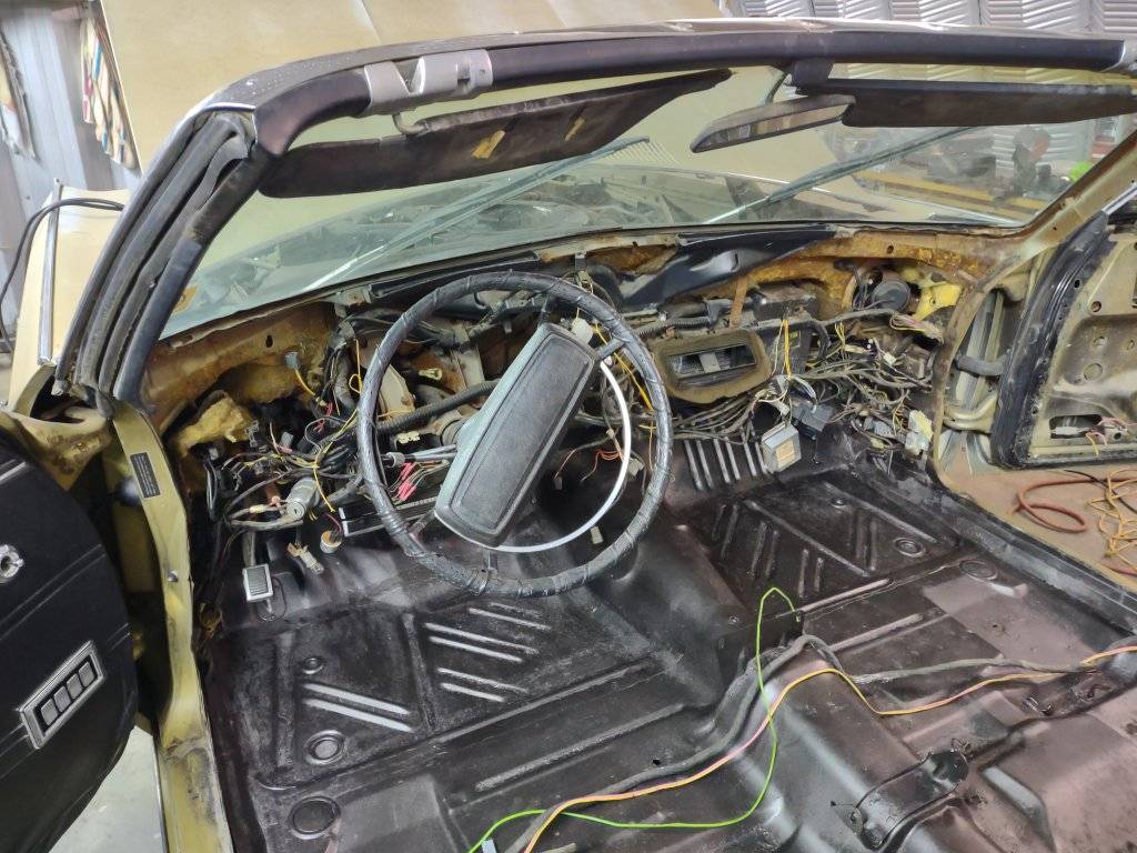

Heres the bulb and socket when the dash was out

Both driver side and passenger side lights come on and off with doors. Ill have to check if they are on a timer.

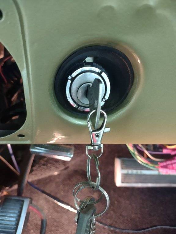

If your ignition key cylinder is like most 1969 Chrysler cars I've seen, the key cylinder is on the dash to the left of the steering column. So Plymouth fury has the ignition key light installed at the far left corner of the instrument cluster flood light panel.
With 1970 Plymouth Fury, the ignition key light stayed in the same place on the same timer, but the key cylinder was moved to the steering column. So with 1970 Plymouth it illuminates the switches, especially the headlight and interior light switches.

Thats how my lock is but i dont have that little light. Mine is huge.

The mount is rusty but nothing under dash was except parking brake. Its not on a timer either so im guessing just a floor light

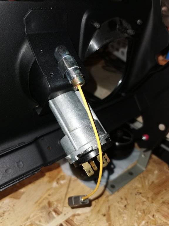

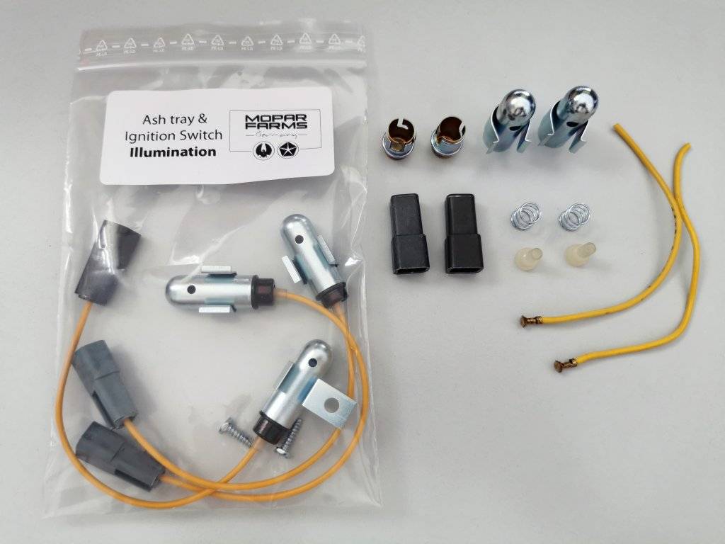

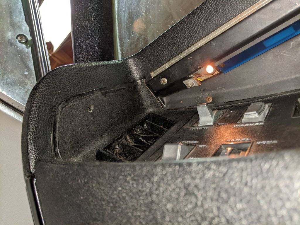

To my knowledge, there are no other interior lights to this style.

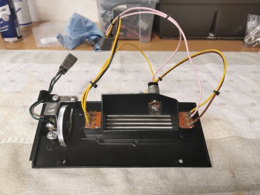

The only exception under the dash would be the map light, which has at least the same cable colors (Pink and Yellow) but has a different socket.
And that is a little bit weird because it's not grounded through the socket, means it's not mounted to metal.
* The Dome Light also has the same wire colors.
