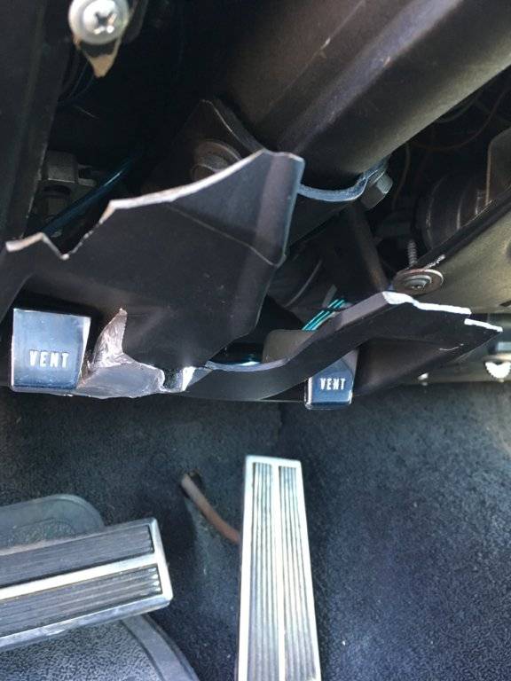

Hey, guys. So I got a replacement lower steering column cover with the vent controls for my '67 VIP. Since the weather's nice today, I decided to go ahead and replace it...with no luck.

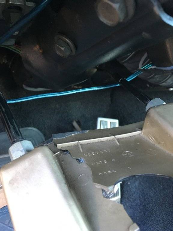

I loosened up the nuts behind the controls, but I noticed that the cable tubes (for lack of a better term) look like they go all the way to the panels on the sides of the foot well. Do I have to remove the side panels just so I can replace this one piece, or is there an easier way? (If any of this makes sense.)
i think you got to go the long way and unhook them from the vent and go backwards... im not sure if there is a trick to it hopefully we will learn somethin today from some old geezer :)
try not to die -
- saylor
Yep, the kick panels have to come off to access the far ends of the cables.. sorry.... :(
