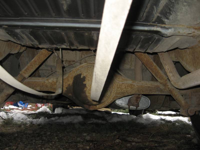

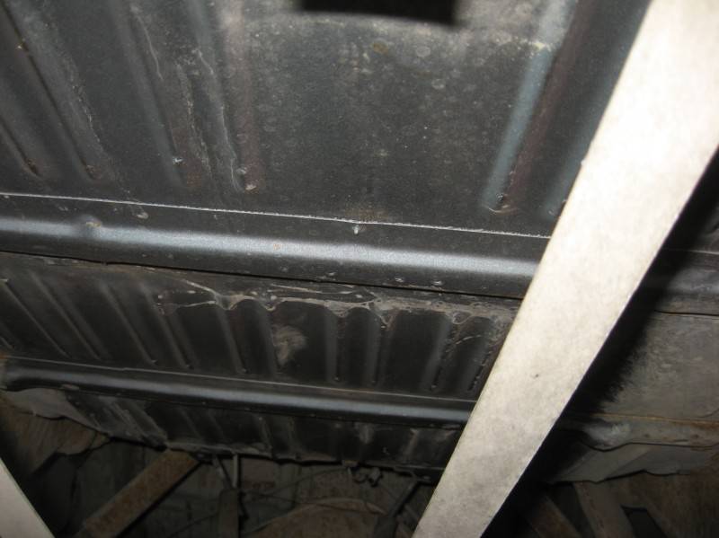

    Here's my B3 Monaco after the gas tank was removed...
