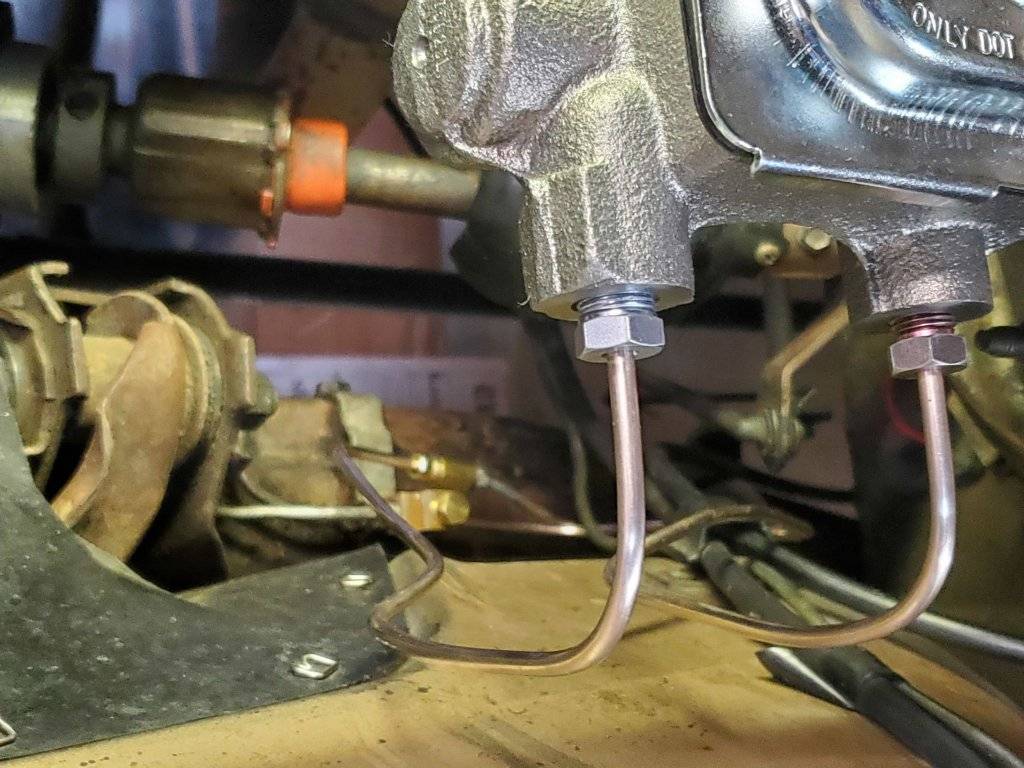

66 Fury III, 4 wheel power drum brakes. Do I have to change my power brake booster when changing my single to dual master cylinder ?

No, I just did this on my 66 Monaco all drum brakes. You will need to make some new lines.

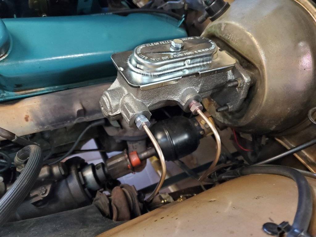

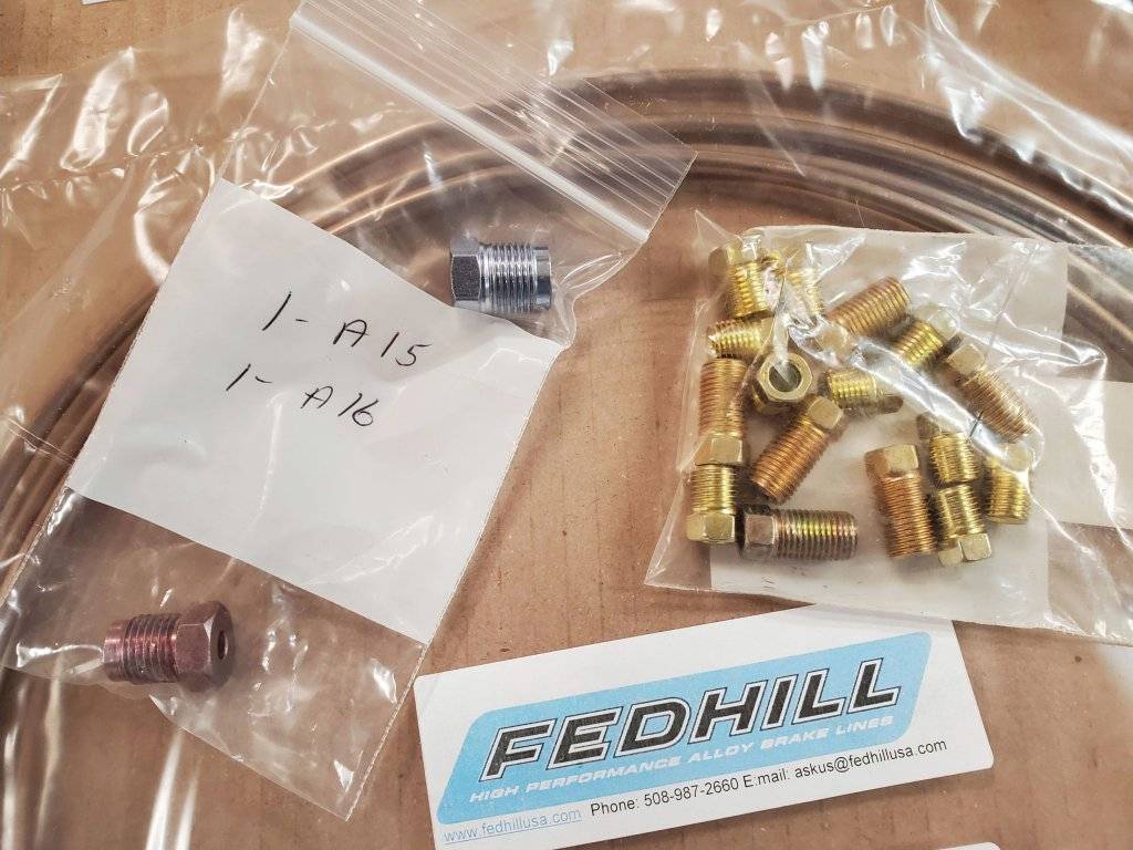

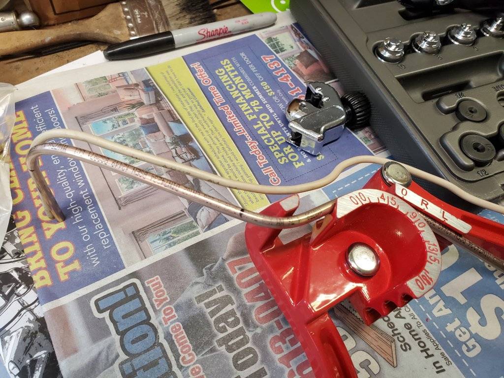

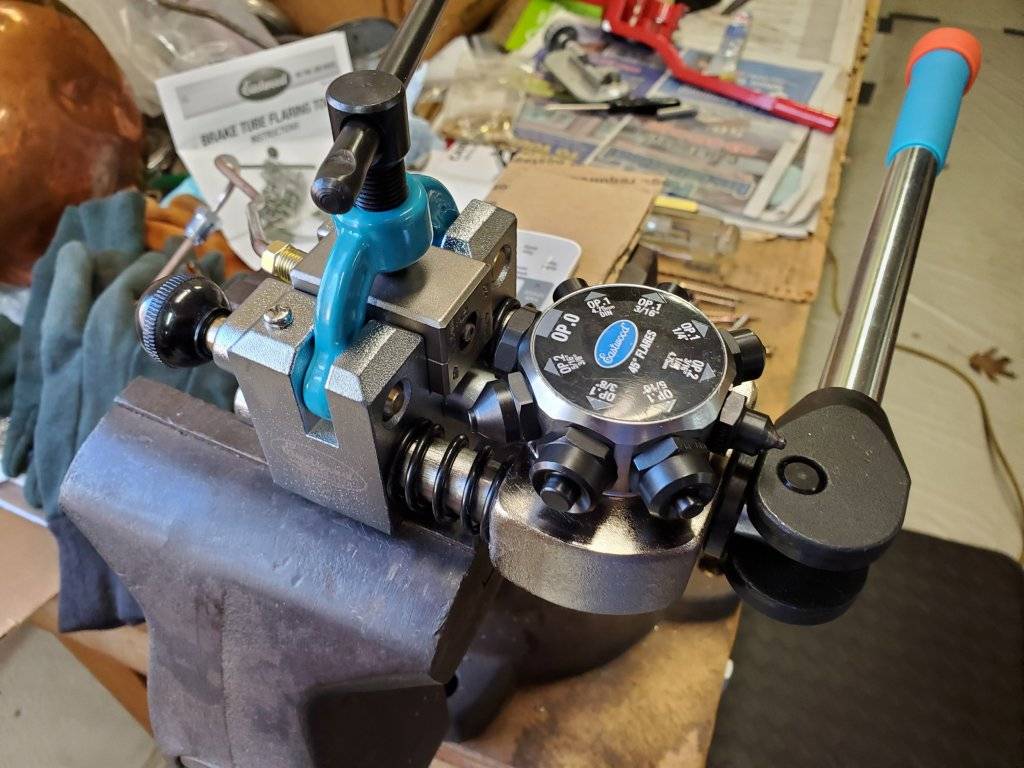

Don, did you make your own lines, or use a kit from Classic Lines, etc?
I made my own using Cunifer tubing and all the fittings from Fedhill. A cheap bending tool worked great, I used 12 gage house wire for a pattern. Bought a cheap double flaring tool and learned a lesson, spent more on a good Eastwood tool and the falres were perfect.

I agree, no need to change booster. Make sure the rear chamber of the m/c (closest to firewall) feeds the front brakes.
