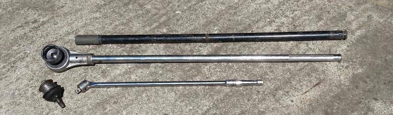

    Get yourself a Torque Multiplier.

    Blackmamba's right... TORQUE MULTIPLIER works wonders. Needed one of these babies to get my upper ball joints off!
