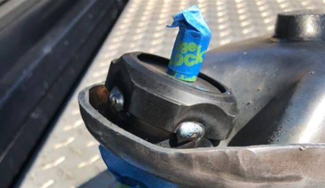

So, putting in my new Moog Problem Solver ball joints and I have a problem. The driver side went in beautifully with no problems. However, I have a problem on the passenger side. First off it went in with very little effort (1/2" ratchet, whereas the driver side needed a 3/4" breaker bar with a long pipe the whole way in!), and now it won't torque at all, it just spins easily even though it's bottomed out. Per the FSM if you can't torque it to "at least 125ftlbs" you need to replace the UCA.
Do I need to replace the UCA or would a tack weld or two be acceptable?
If I need to replace the UCA, does anyone have a passenger side for a '71?
I know I could possibly solve my problem with new tubular UCAs from Firm Feel, but after spending a huge amount on my suspension I'm not sure I see the value in it unless I have no better (economical) option.

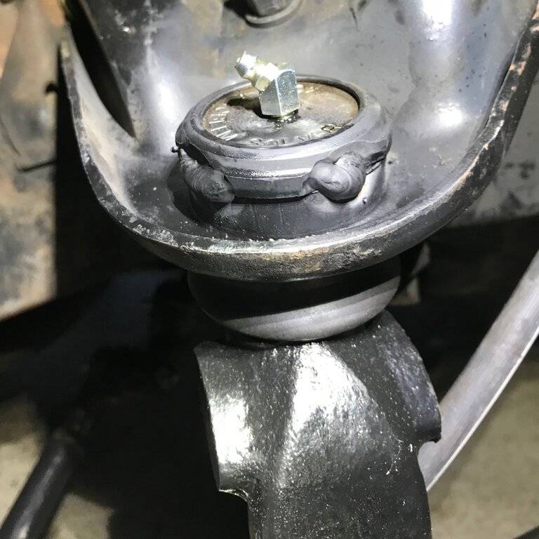

It's acceptable to weld the ball joint to the upper arm.
On a collector car, it's likely that it will never need to be replaced again.

Back then, "later replaceability" was a prime consideration, which meant "no welding" on the suspension parts. Plus, "going overboard, for good measure" could put more heat into the metal, but which might also cause it to fail later. Not good!
But once you get it all installed, adding two small tacks would probably be fine. Should they need replacing, for whatever reason, a little grinder-wheel action would undo things. Proceed at your own risk, FWIW.

Just a few tacks is all I did when I had the same problem but I did quickly swap the whole uca that had a good solid original ball joint still in it. I just don’t like the quality of today’s junk, give me good used any day.

A few tack welds and yer golden.
Shops have been doing that for years on F/M/J bodies,B series vans and pick em up trucks lol.
Wjen it comes time to replace the ball joint again cut the tack welds and weld in new joint again.

Had to weld one on my Dakota 2 years ago....a pair of good tacks and it's been fine ever since.I did get 50 ft lbs on it before tacking.
