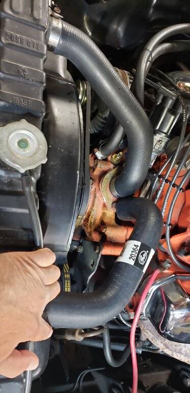

Here is the hose I received.
So your saying the radiator I have is a 22 inch not a 26 inch?? Or are you saying from the driver point of view the 22" rad hose enters the rad on the drivers side and the 26" rad on the passenger side...
Being an AC car it should be and is a 26" radiator. A tow package car would also be a 26". Non AC cars got the 22". I agree with cat, that looks like a hose for a 22" radiator.

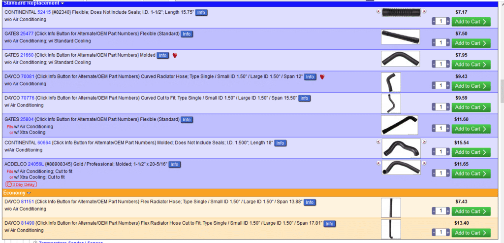

If you cannot find one specifically for your car the top hose on a 68 goes to the passenger side. Here are the upper hoses listed on RA. Maybe one of them is the same as one listed for your car. That would confirm that it goes to the passenger side.
My 69 has a 440 but not an original radiator.. But it is 26 and it does have a passenger side opening. I used Gates 20630.
Rockauto seems to have run out of stock of the correct molded hose (Gates #20630).
As I see it, the three best options are:
Gates #20630 (440HP), L=16”,
Continental #60664, L=18” or
Continental #60665 (Imperial), L=22”
However, the Gates part seems only to be available on eBay at the moment. Starting at +$21 plus shipping.

Thanks to all for your help and thoughts. I do appreciate it. I will be returning the hose back[gates 20364] to Rock Auto and exchange it for a Continental 60664.
