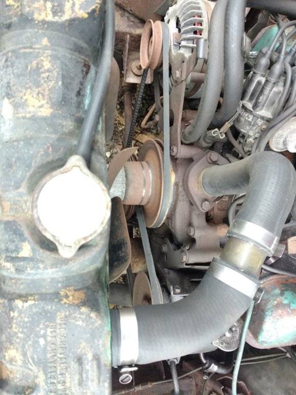

Can anyone explain to me why I can’t find the correct upper radiator hose for my 68’ Newport w/o a/c? The problem stems from the fact that my factory looking radiator has the inlet on the left inboard side of the radiator.... every hose I can find is only for a radiator that is either right inboard (Non a/c models) or right outboard (a/c models). Prior to today, I just figured the previous owner cobbed the upper radiator hose because he was cheap, now I am starting to understand he probably had the same problem....I’m getting very frustrated! Any help and/or info will be greatly appreciated, Thanks!

Pretty sure non A/C cars have the upper house connection on the other side of the radiator cap. I had the same issue on my 383 Newport.

Ok, here is what I found. I checked the number on the radiator in my parts manual for the 68’s... the number indicates it is for either a 68 Belvedere or a 68 Coronet, for their 440 engine. So in looking for hoses at Rockauto, they do have a Dayco hose that looks correct for my application.... so, until I find myself the correct radiator, I am purchasing the Coronet upper hose. Thanks for the help, all!
