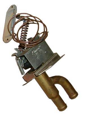

The hoses going to the heater core on your car first go to a valve. From what I can tell it is a bimetallic valve that allows more flow as the coolant temp increases. That would be the hose on the lower right side of the firewall looking at it from the front of the car. The short hose is the supply to the heater core. In the heater box there is also another control valve that is opened by the cable. What you may have to do is split the system into it's 2 parts. Disconnect the 2 hoses from the heater core, those will be the 2 by the valve cover, hook up garden hose where the short hose goes, you should have good flow through the core if the control valve is open. If not you will have to go from that point.
I've read this 5 times now and it still make no sense whatsoever. There's a short hose that looks more like a bypass then anything else as the 2 are tied together before it goes into the wall!
This is the valve on the lower left of the firewall. The hose from the water pump goes to the lower port of the valve, the short hose comes out of the upper port going to the heater core. Hope this helps.
